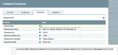

Hi @Sumit Sharma,
you can use replace text processor to extract and replace text as per your requirement.
Change the search value property to:-
(.+?)\s+:INFO.*Receiver Node\s+(\[.*\])\s+(?=,).*Sender Node\s+(\[.*\])\s+(?=,).*Message\s+(\[.*\])$
Change Replacement Value property to:-
Date: $1 ,sender: $3,Receve: $2, Message: $4
ReplaceText processor Configs:-
Input :-
[16 Aug 2017 12:13:50,665] :INFO :UDPListener : UDP Listener ::: Receiver Node [ 0.0.0.0/3333 ] , Sender Node [ 20f:feb:1:0:0:0:0:10e ] , Message [ <30>Aug 16 12:13:50 as-pp-aa[1761]: %DAEMON-6-SNMP_TRAP_LINK_UP: ifIndex 669, ifAdminStatus up(1)]
Output:-
Date: [16 Aug 2017 12:13:50,665] ,sender: [ 20f:feb:1:0:0:0:0:10e ],Receve: [ 0.0.0.0/3333 ], Message: [ <30>Aug 16 12:13:50 as-pp-aa[1761]: %DAEMON-6-SNMP_TRAP_LINK_UP: ifIndex 669, ifAdminStatus up(1)]
So this processor works dynamically according to the ff and replaces the content with your specifications.

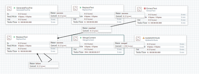

I think right now your flow looks like
GetFile-->SplitText(splits 1 line as separate flowfile)-->Replacetext(to prepare your content)
You need to have the below processors to get your desired result.
Final Flow:-

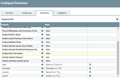

GetFile-->SplitText(splits 1 line as separate flowfile)-->Replacetext(to prepare your content)-->ExtractAttributes(to get contents as attributes)-->ReplaceText(to replace attribute values as content of ff)-->MergeContent(to merge the ff as one with header).
Extract text processor:-
After looking at your output you just want all the values of the content to be stored as seperate for this case first we need to extract contents of ff as attributes of ff.
by adding new properties to the processor
date as
Date:\s+(.*)\s+(?=,)
Message as
Message:\s+(.*?)$
Receve as
Receve:\s+(.*?)(,)
sender as
sender:\s+(.*?)(,)

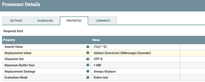

once we extract the contents of ff as attributes then we need to use
ReplaceText Processor:-
change Replacement Value to
${date} ${receiver} ${Message} ${sender}
then change Replacement Strategy property to
Always Replace
config screenshot:-
Input:-
output:-
[16 Aug 2017 12:13:50,665] [ 0.0.0.0/3333 ] [ <30>Aug 16 12:13:50 as-pp-aa[1761]: %DAEMON-6-SNMP_TRAP_LINK_UP: ifIndex 669, ifAdminStatus up(1)] [ 20f:feb:1:0:0:0:0:10e ]

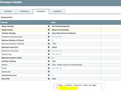

Once we replace values then use
Merge content processor:-
To merge the flowfiles to one(depends on your requirement).
Change the below properties
Delimiter Strategy to
Text
Header to (as per your requirements and do shift+enter to insert new line)
Date : Sender: Receiver Node Message:
in my processor i kept minimum group size as 500 B , so this processor will waits until the queue size before merge content to 500 B and merges all the ff to one and gives the merged ff.
Input:-
in my case every ff is 170 B now so the processor waits for 3 ff then the queue size is 520B
Output:-
your desired output 🙂
Date : Sender: Receiver Node Message: [16 Aug 2017 12:13:50,665] [ 0.0.0.0/3333 ] [ <30>Aug 16 12:13:50 as-pp-aa[1761]: %DAEMON-6-SNMP_TRAP_LINK_UP: ifIndex 669, ifAdminStatus up(1)] [ 20f:feb:1:0:0:0:0:10e ] [16 Aug 2017 12:13:50,665] [ 0.0.0.0/3333 ] [ <30>Aug 16 12:13:50 as-pp-aa[1761]: %DAEMON-6-SNMP_TRAP_LINK_UP: ifIndex 669, ifAdminStatus up(1)] [ 20f:feb:1:0:0:0:0:10e ] [16 Aug 2017 12:13:50,665] [ 0.0.0.0/3333 ] [ <30>Aug 16 12:13:50 as-pp-aa[1761]: %DAEMON-6-SNMP_TRAP_LINK_UP: ifIndex 669, ifAdminStatus up(1)] [ 20f:feb:1:0:0:0:0:10e ]

Flow Screenshot:-
