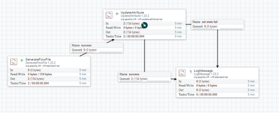

Below image are the NiFi UpdateAttribute Processor which show the processor ID that i used inside my HTTP URL
Just to check did i did it correctly as what you mention in your reply ?

I noticed that the invokeHTTP processor will only POST request to clear state when the updateAttribute processor  which contain the state is STOP.
Error Message:
i got from invokeHTTP processor "UpdateAttribute[id=e6c537bd-c24b-1801-6fdd-b37c23c97fcd] cannot be updated because it is not stopped"
1) If it is true, how can i make the invokeHTTP processor to clear the state when the updateAttribute processor is running
2) If it is not true, what are the step or setting i should set to make sure the invokeHTTP processor clear the state of the updateAttribute processor while both processor is running ?
