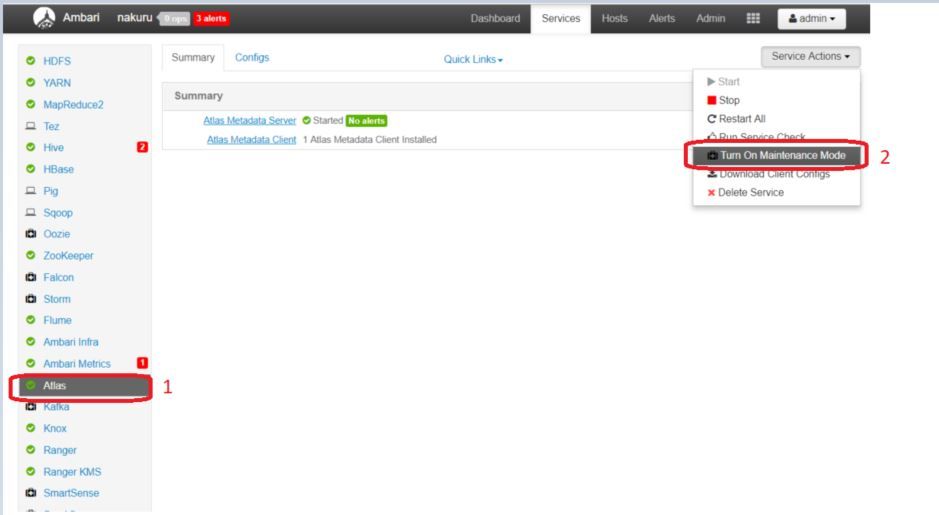

@Victor Hely
Your Atlas is in maintenance mode !! Can you go to the Ambari UI see attached screenshot Turn Off Maintenance mode and restart Atlas ensure Hbase is running all should work.
If all works remember to accept the answer so others can also use it to resolve similar issue
