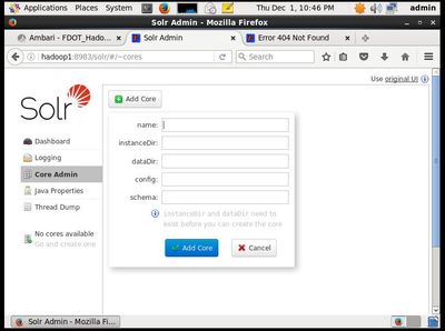

I noticed there are no cores available in SOLR admin , so do I have to create a core before I can connect with the above url ? if yes can you please guide me on how to do that ?

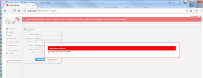

ok I copied the solrconfig.xml and schema.xml files into the /root/solr-6.3.0/server/lib folder but now I am getting this error :

@Sami Ahmad - You've got a couple of things going on. It looks like you are not using the Ambari Infra Solr installation. To use an external Solr, follow these instructions. You'll be using scripts rather than the UI to create the collection.
The version of Solr you as using may not work with Ambari. You should use 5.2.1 or 5.5.2 to be consistent with what's released with HDP. If you go to 6.x, being a major release, you may encounter significatn issues. Also note that $SOLR/server/lib is not the directory where your config files wold belong with Solr anyway. Normally you'll put them into a "config" directory somewhere. They cannot be in a directory with binary files or you will definitely encounter issues when it tries to load the directory into Zookeeper and then you have a bigger mess to clean up.

A.so, to install the right version of Solr, I'd recommend this page: https://docs.hortonworks.com/HDPDocuments/HDP2/HDP-2.5.3/bk_security/content/installing_external_sol...
