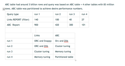

Here are the details based on a test done in my env.
run 1 vs. run 2
Thanks for sharing! How many datasets were in the Links table? Is the dataset in Links a subset from the ABC dataset?
Master Mentor
ABC and Links were separate tables. @Jonas Straub
ORC+ZLib seems to have the better performance. ZLib is also the default compression option, however there are definitely valid cases for Snappy.
