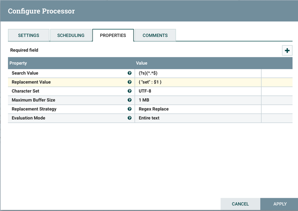

@arunnalpet This sounds like a perfect job for ReplaceText:
I did notice that you have set as $set. In order to maintain a real json object, I have used just "set". The set object is available as $.set if you use EvalateJsonPath. If you still need $set, please explain...
Below is the configuration you need for ReplaceText. It regex matches the entire flow file then adds the prepend before $1 and adds the append after.
{ "set" : $1 }
(this is the only change in the processors from default)
And the output:
{ "set" : { "first_name": "alpha", "age": "30" } }

Thank you! This gives me some directions.
One thing though is that, i really want it to be "$set" and I am not expecting it to comply to JSON standard after doing this.
So I guess i can just use $set in the replacement value and get the job done. (i think we need to escape $ value). Will try it out and get back.

@arunnalpet yes that is correct. I wanted to avoid $set in basic testing and also advocating for valid code practice to avoid issues further with the data source.

Actually I am working on MongoDB queries, which supports 'Extended JSON' as opposed to 'Standard JSON'. For which I need to enforce $set. Is there a way we can implement this?

@arunnalpet You should be able to just add the $. If it doesn't work, maybe have to escape it: \$
