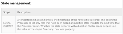

For example, look at the embedded docs for ListFile and you will see a "state management:" section with:
Above you see that this processor can use local or cluster state provider and a description of how state us utilized by this component. Configuration of the "Input Directory Location" in the case of this specific processor controls which provider is used.
