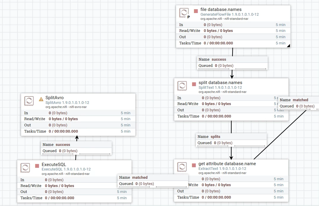

The below pic shows the steps:

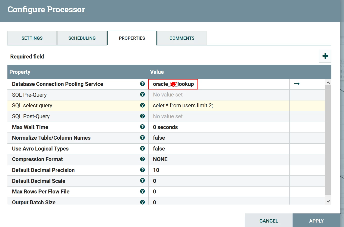

the below pic is config of ExecuteSQL:

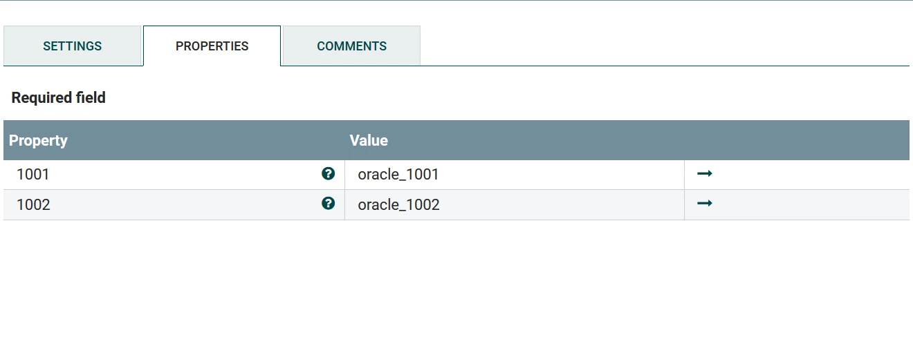

the below pic is lookup service:

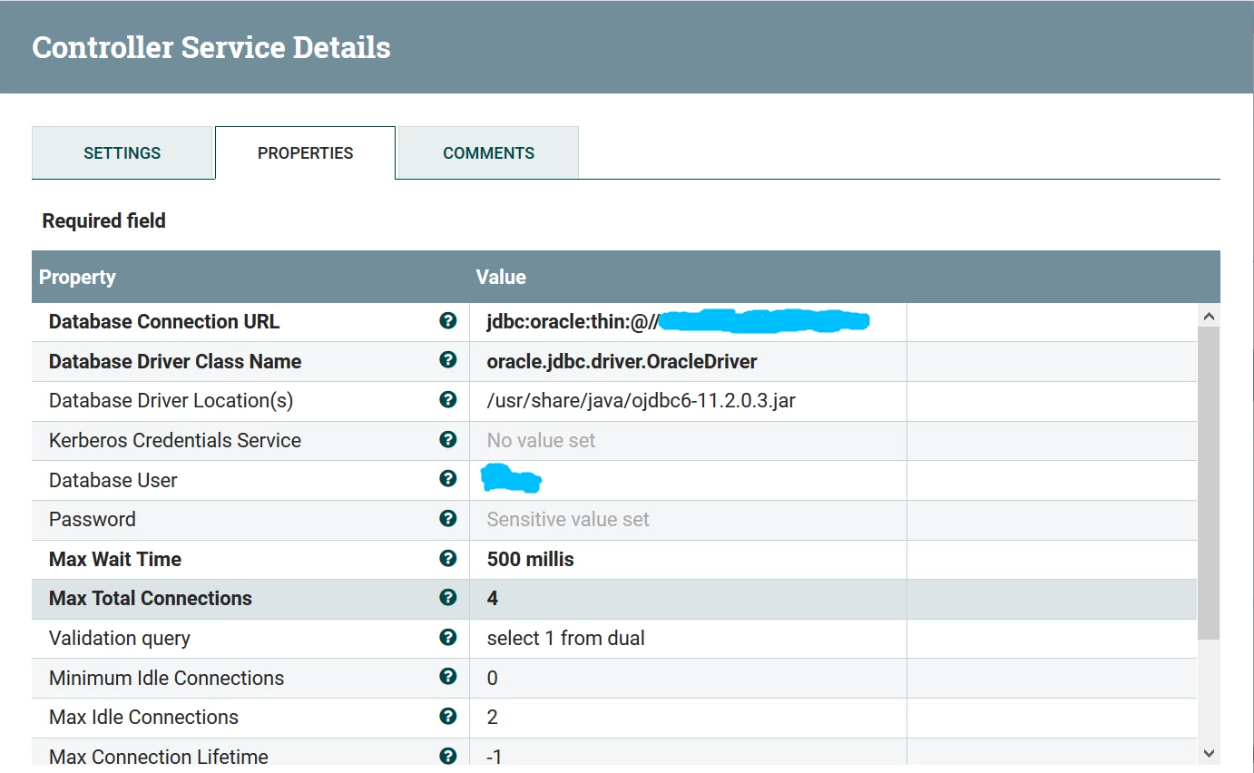

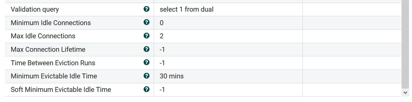

the below is the config of dbcpconnetionpool:

Oh, it is network connection issue. it gone away when i add oracle.jdbc.ReadTimeout=120000 and oracle.net.CONNECT_TIMEOUT=10000 to config of DBCPConnectionPool.
