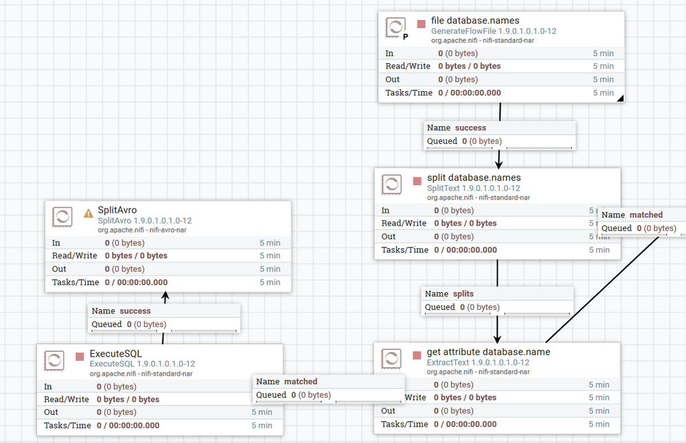

The below pic shows the steps:

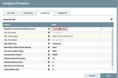

the below pic is config of ExecuteSQL:

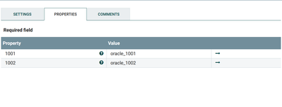

the below pic is lookup service:

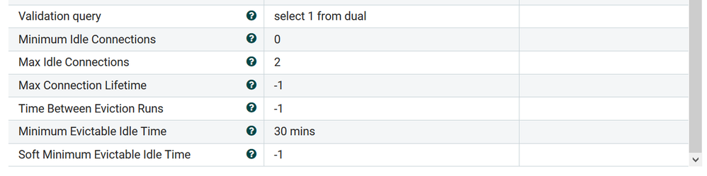

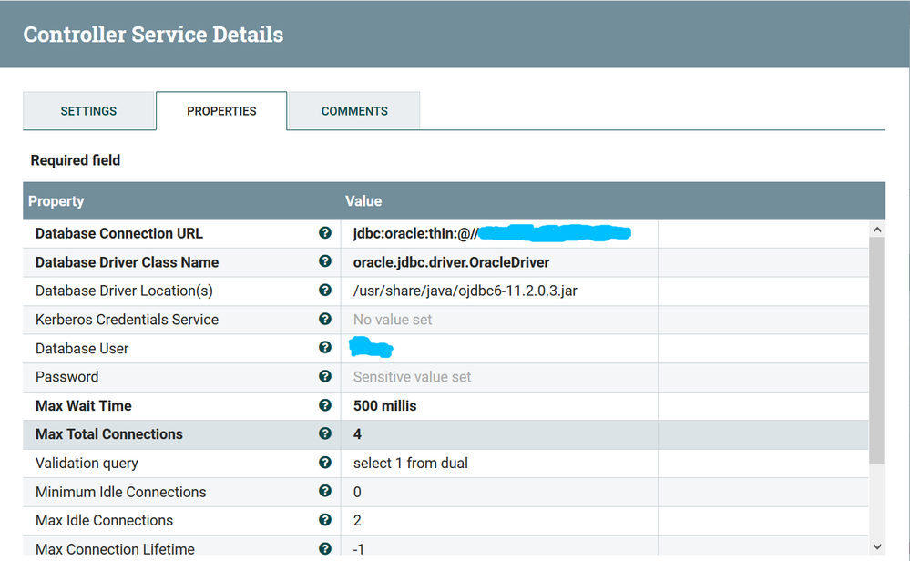

the below is the config of dbcpconnetionpool:
The behavior is the ExcuteSQL processor will execute very slowly seem hanged.  but sometime execute very fast. I believe that is database issue. So my questions is:
1. what is the impact? is dbcp connections pool issue of config? or is the dbcp connections pool lookup wrong behavior?

Oh, it is network connection issue. it gone away when i add oracle.jdbc.ReadTimeout=120000 and oracle.net.CONNECT_TIMEOUT=10000 to config of DBCPConnectionPool.
