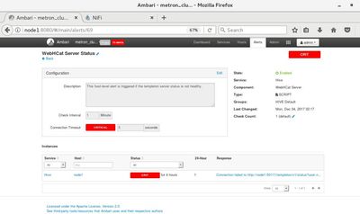

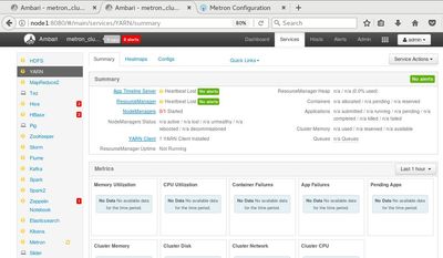

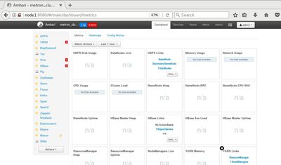

@asubramanian
Why am I facing heartbeat issue over all services??

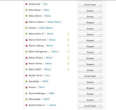

@asubramanian
How do I solve this errors??
43805-capture73.jpgMy services go down and when I restart them they fail to go up

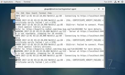

@asubramanian
I checked the logs and it seems there is a SSL connection error, please help me with the steps for the same??

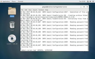

@asubramanian
I have got these two logs of ambari-agent and ambari-server, please help with the steps to fix the problem.
Also, I am losing heartbeats on all components , what might be the issue ??
