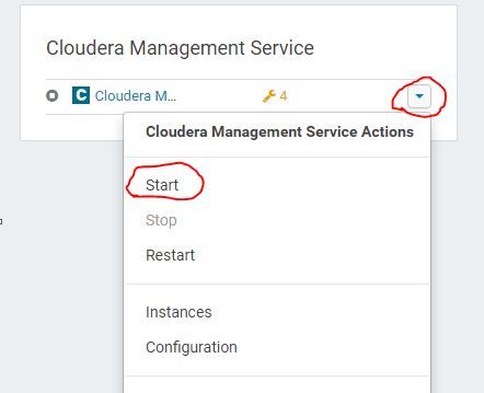

@anhthu
You will need to fire-up your cluster  start by scrolling at the bottom  see the attached screen and start the Cloudera Manager [CM]  the blue triangular shape will give you a drop-down menu chose start you will see some startup logs and if all goes well it will be green
You can see exactly the same error I have on my Quickstart sandbox because my service are not started  again see the attached screenshot on the blue inverted triangle you will see a drop-down list chose start the services. This will start all the service in the right order ,again once all is GREEN you are good to go
Happy Hadooping
