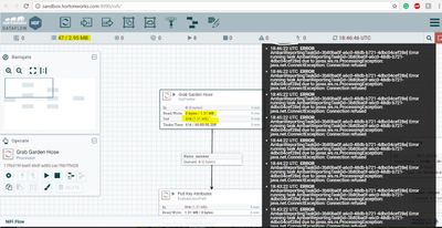

I am trying to do a POC of sentiments analysis using nifi and banana. I was able to setup everything but unfortunately I am unable to see any data in Banana, however I can see sometimes data are coming in nifi. Please see the below screenshot to have a look at the error.
I had almost tried everything that was mentioned everywhere as a solution like switching off the firewall, making sure about the port forwarding in virtualbox etc.

One thing to point out: the "java.net.ConnectException: Connection refused" error is not related. It just means that Ambari metrics service is probably not started - it's usually turned off by default on sandbox, to conserve resources
From the screenshots it seems the flow was started and tweets are flowing. If you can not query them in Solr UI/APIs, I would check if the PutSolrContentStream processor in Nifi is showing any errors - sometimes the zookeeper zknode that solr is using may not be correctly specified in its settings. In this example, I used the Solr ambari service which usually sets up Solr to use /solr zknode
If you are able to query tweets in Solr, but not in Banana try to switch the "Time Window" or re-installing the .json file for the dashboard

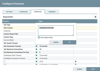

Right on! This worked for me. Thanks a ton! What I did: 1. Deleted my sandbox and re-installed it.
2. Configured PutSolrContentStream processor's Solr Location to localhost:2181/solr
3. Turned on Ambari metrics service. I really appreciate your input. Thanks for sparing the time.
