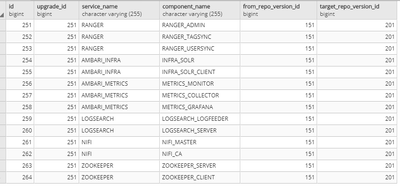

@Ilya Li looks like you have null reference in upgrade_history table.
Can you review the entries from below query and see if from_repo_version_id, target_repo_version_id are NULL.
select * from upgrade_history; //Look for zookeeper entry and correct that to valid repo version id.
After correcting that you would need to restart ambari server before attempting the upgrade again.
Visitor
This is the last upgrade_history

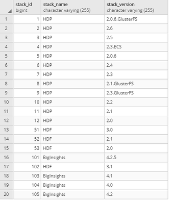

Hi @Ilya Li ,
Can you please have a look at this table
select * from repo_version;
select * from stack;
I hope you will get some clue.
probably the stack_id of newly registered 3.1.2 will be pointing towards the wrong stack in stack table.
As Amar suggested I would suggest you downgrade the cluster
do the service checks on the zookeeper. change some configs in zookeeper and make sure it works. and then proceed with upgrade.
Visitor
I made downgrade, service check on the zookeeper. Nothing helped. Which configs do I need to change in zookeeper?
stack:
repo_version:
cluster:
Hi @Ilya Li,
Oh this commands everything seems to be ok.

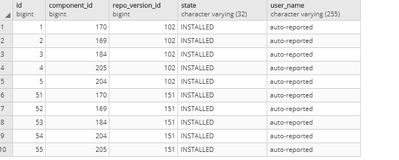

Can you investigate further with this commands :
1) SELECT id, component_id, repo_version_id, state, user_name
FROM ambari.servicecomponent_version;
2) select * from servicecomponentdesiredstate where service_name='ZOOKEEPER';
3) select * from repo_version where repo_version_id in ( select desired_repo_version_id from servicecomponentdesiredstate where service_name='ZOOKEEPER');
4)  select * from repo_version where repo_version_id in ( select desired_repo_version_id from servicecomponentdesiredstate);
5)  select * from servicecomponentdesiredstate where desired_repo_version_id not in ( select repo_version_id from repo_version);
If you happened to see two repo_versions in command 3 and 4 or get some output for command 5 ( which is empty in my env ) you can suspect that's the wrong entry in database and act accordingly.
Hope this helps.
Visitor
1)
2)
