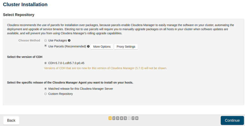

actually I am testing cm5.7.0(el6) + cdh5.7.0, and after the installation of cm and the setup of cdh parcels, the webpage told me that "cdh5.7.0 are too new of cm5.7.0". Any one can explain this?
| cloudera-manager-el6-cm5.7.0_x86_64.tar.gz | 2016-04-02 00:18 | 573M |
| CDH-5.7.0-1.cdh5.7.0.p0.45-el6.parcel | 2016-03-31 19:56 | 1.3G |
By the way, why the url "http://archive.cloudera.com/cdh5/parcels/latest/" targeting to
| 5.3.10/ | 2016-04-21 07:31 | - |

Ah ok 🙂 - Per your comment, you are in CM 5.7.0 and the page is listing version CDH 5.7.0.
As the message indicate "Version of CDH that are too new for this version of Cloudera Manager (5.7.0) will not be shown" what the message effectively saying is that, if there was a version eg: CDH 5.8.0 that page won't show it.
Per specification:
Cloudera Manager minor version has to be equal to or greater than the CDH minor version.
For example:
| 5.0.5 | 5.0.x |
| 5.1.4 | 5.1.x |
| 5.4.1 | 5.4.x |
References
http://www.cloudera.com/documentation/enterprise/latest/topics/cm_mc_upgrade_cdh4_to_5.html

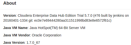

Can you let me know your Cloudera Manager version, this should be in the CM Web UI in the top-right menu Support> About

Created 05-16-2016 03:08 AM
It seems that both cm and cdh version are 5.7.0

Indeed, you do appear to have version CM 5.7.0.
Would you mind posting a screenshot of the page that showing the error, the list of available parcels on your CM from the parcels url
- http://CM-SERVER:7180/api/v12/clusters/REPLACE_WITH_CLUSTER_NAME/parcels
- http://CM-SERVER:7180/api/v12/clusters/REPLACE_WITH_CLUSTER_NAME/parcels/usage
and finally yourREMOTE_PARCEL_REPO_URLS from the following url
- http://CM-SERVER:7180/api/v12/cm/config
Thank you

I tried to setup a new cm server, but installation can go on, it seems just a warning.
Created on 05-18-2016 06:09 AM - edited 05-18-2016 06:15 AM
Per specification:
For example:
| 5.0.5 | 5.0.x |
| 5.1.4 | 5.1.x |
| 5.4.1 | 5.4.x |
References
