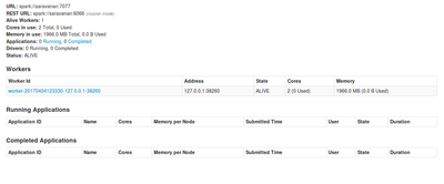

My set up is as follows: 1 laptop where i am running wordcount scala program through spark-submit command. The input for my application is a text file which is placed in HDFS. I'm using Spark's standalone cluster for managing my cluster. I'm running my application on a kind of pseudo distributed mode. while executing spark-submit command i don't use --executor-memory option. My execution command looks like this? I would like to know that how much memory will be allotted to executor by default when --executor-memory option is not given. My interface looks like the one in the image attached.
spark-submit --class Wordcount --master spark://saravanan:7077 /home/hduser/sparkapp/target/scala-2.11/sparkapp_2.11-0.1.jar hdfs://127.0.0.1:9000//inp_wrd hdfs://127.0.0.1:9000//amazon_wrd_count1

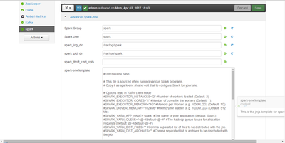

Default executor memory will shown at spark->config->Advance spark-env, for reference check the attached image.

Ok. thanks. Now i understood that by default the amount of memory allotted for an executor is 1 GB and this value can be controlled through --executor-memory option. Now, I would like to know that By default, how many executors will be created for an application in a node and what is the total number of executors created in a cluster? How to control number of executors created in a node? Also, by default how many cores will be allotted to an executor in a node(I think that the number of cores allotted for an executor is unlimited in a node.Am i right?)?
