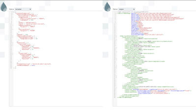

My simple flow:
The input XML:
The output JSON:
ConvertRecord Configuration:
XMLReader Configuration:
Several questions arise:
  1. Why are position and ncsmTrackData null?
  2. Why are all the attributes on fltdMessage being ignored?
  3. How can I see the inferred schema?
  4. What is a proper schema to correctly transform those two null fields, (along with the rest of the transformation as it currently looks ok)?

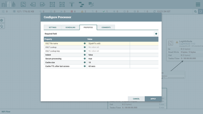

@David Sargrad , I faced the same issue and I believe that the nested structure of your XML is causing inferredSchema to fill null in those attributes. I came across this post, it suggested using a XSLT file to transform the XML directly to JSON. The inferred Schema works great for flat XML files.
You might want to give it a try or you can manually define a schema for the file you want to convert.
Here is how you can use the XSLT to transform the XML.
Configuration of TransformXML processor
Save the XSLT file and add the path to the file at XSLT file name

I fiddled with the XML and I found that the issue is having data in form of XML attributes. For example if the longitude and latitude data is in this format, you get the desired output.
Seems like there is some issue in the XMLReader. I upvoted your JIRA issue. Lets wait and see. Thanks for your response.
