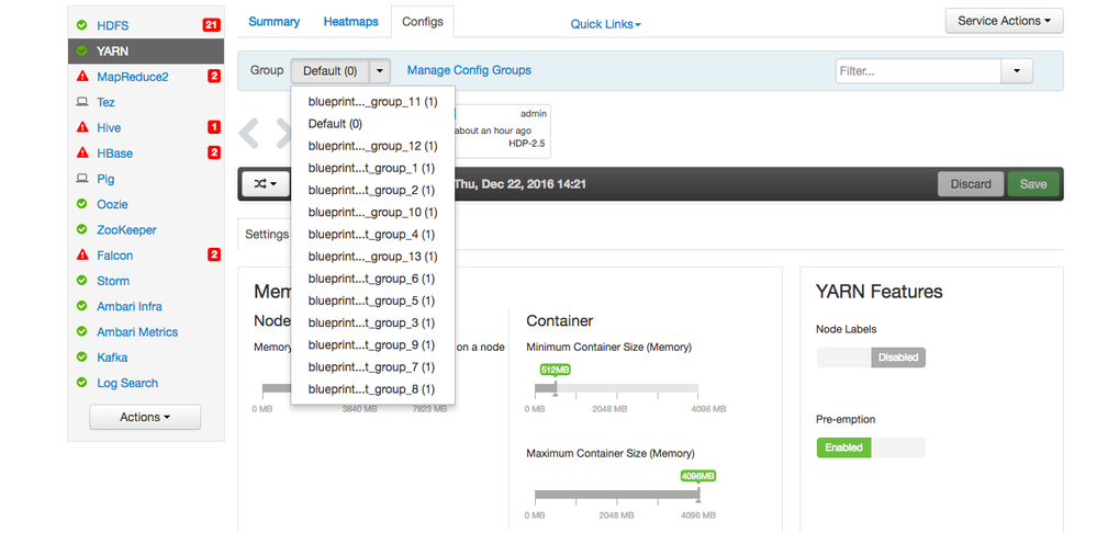

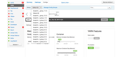

I am also facing the same issue -- I see cloudbreak creates config group for HDFS and YARN service while the same in not mentioned in blueprint definition. How do I say cloudbreak to not create config group ?
