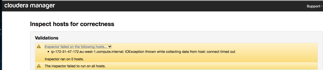

When running the wizard for installing the cloudera hosts all goes fine until the moment clooudera manager wants to inspect the hosts.
So I used the wizard but still there are issues.
I have tried already to edit the etc/hosts and put the interal address in the hosts and then I tried to rerun the installation but the problem persists.

I just got around this problem.
The problem is that cloudera manager is trying to contact the host by using port 9000.
So I added port 9000 to my security group config.
Now I'm at the point where the client config will be deployed. Let's hope this goes fine.
Maybe I need to identify all the ports being used for the deployment on AWS.

Hi Koen
Our blog post at http://blog.cloudera.com/blog/2013/03/how-to-create-a-cdh-cluster-on-amazon-ec2-via-cloudera-manager... gives a good starting list of ports you'll want to ensure are in your security group config. See also http://www.cloudera.com/content/cloudera-content/cloudera-docs/CM4Ent/latest/Cloudera-Manager-Instal... for a full list of possible ports for inter/intra-node communication.
