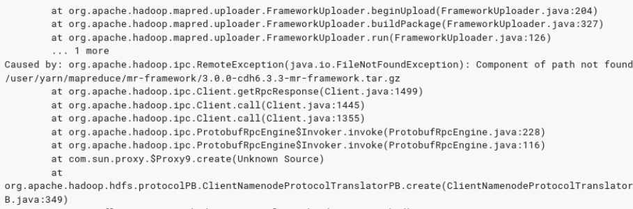

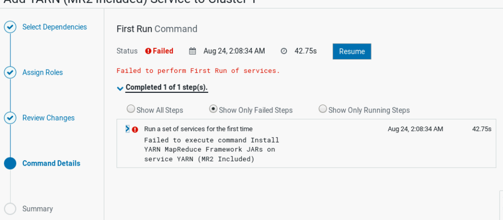

i am installing cloudera cdh  6.3.3 with isilon but when adding yarn i am facing this error
any help i will be grateful

@farouk This seems a known issue and I used to fixed it by adding the required permission : hadoop dfs -chmod -R +x /user/yarn
Can you please try this and see how it goes.
Cheers!
