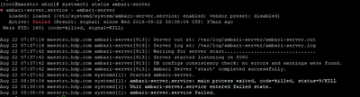

hi, somebody know why pass this error:
New Member
ambari-server.service: main process exited, code=killed, status=9/KILL

@yadir Aguilar where and when do you see this error?
New Member
when a the heartbeat don't have response, i run this code: systemctl status ambari-server, so in here i get this error, i execute some commands and the service is runnig again, but this problem pass repeatedly
