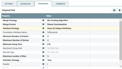

Hi @SAMSAL , I am doing the same but still not getting the desired output.
Can you refer snapshot, Am i missing something?
Super Guru
first you need to check if there is an attribute called filename on the original flowfile and its the same passed the output stream flowfile. If there is, then you should specify it as "filename" in the merge content property and NOT as "${filename}".
Contributor
Hi @SAMSAL, thanks a lot for you help. I'm getting data as expected.
