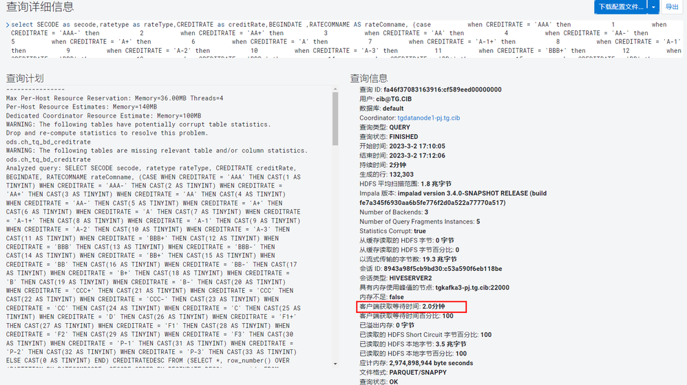

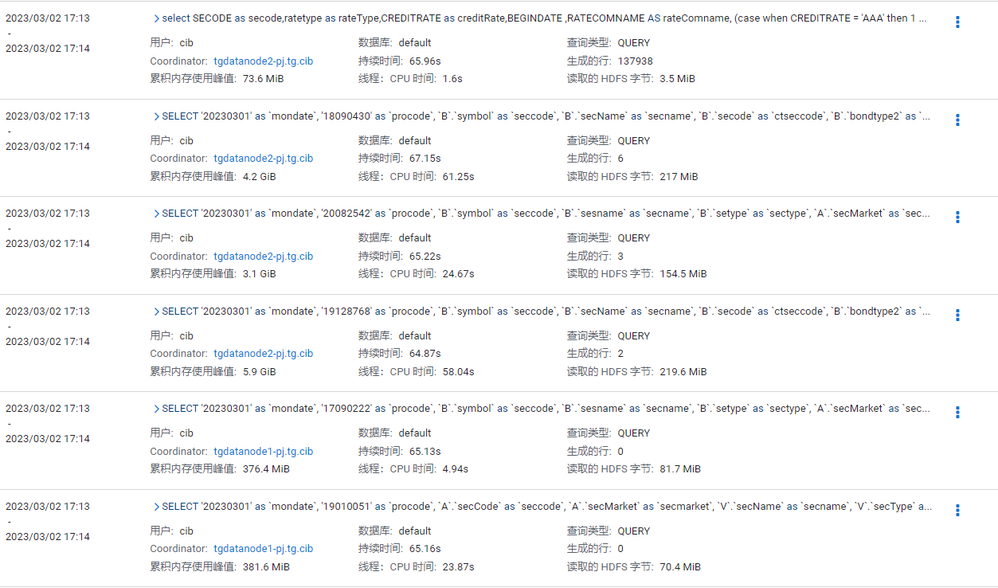

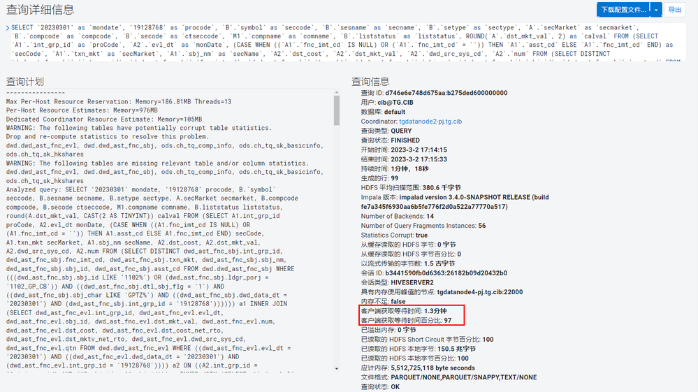

impala执行sql语句时速度不稳定,同样类型的sql存在十几秒完成,也存在几分钟才完成,从sql执行持续时间上来看,[客户端获取等待时间]占整体时间占比很高,请问是什么因素会影响[客户端获取等待时间]
负载均衡中间件:Haproxy
负载超时时间设置:30m
查询慢的脚本
查询慢的脚本1查询慢的脚本1查询慢的脚本2查询慢的脚本2查询慢的脚本3查询慢的脚本3

Hi @KaimingGu , the translation might have been incorrect, so I assume you're actually facing "Client Fetch Wait Time" taking the most of the time. At the same time the "Client Fetch Wait Time Percentage" is also close to 100%.
This means that while the query has been executed quicky, the client was too slow to fetch the results. This is usually a sign that the network may be slow or the client is facing other slowness, for example it does some processing between the "result.next()" calls, or hitting GC pauses (if it's a Java application).
