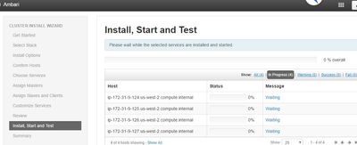

The installation has been hanging in last step - show 0% overall for long time. All previous steps were OK.
- How to check what is exactly happening ? is there a logfile somewhere on server can check ?
- How to do a restart/a fresh start ?
i had tried to interrupt the installation (kill -9 back end, even restart the server). But when i restart the server, seems Ambari jump to the last step directly and continue hanging.
- FYI, i am trying to setup a 4 nodes cluster under Redhat 7. HDP 2.3

Hi @Allen Niu
Can you attach the screenshot here of the screen on which you are struck.
Also do check below -
1. Login on ambari server and change path to - $cd /var/lib/ambari-agent/data/
2. $ ls -ltr output-* and $ ls -ltr error-*
3. Check the last output or error file to see if there are any useful logs.

Hi Sagar,
Thanks.
See below screenshot and log.
a) No error and seems not too much info in output*.
b) One thing noticed the timestamp of last file (hostcheck.result) is few minutes back. Does this means it is still running, but just slow - about 1 hour 40min from 2nd last log?
Regards,
Allen

Explorer
Yes. I did use the local repository. It seems i did not change the local repository under /etc/yum.repos.d. After i added, i have restarted the installation (wiped out the ambari repository and created a a new one) and it seems progressing. Finger crossed till the completion.
