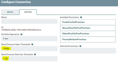

If you dont want to see the queue in red color then click on success relation and click on settings tab,
then configure that queue to big number and size as per your needs, by default these configurations are 10000 flowfiles or 1 GB size.

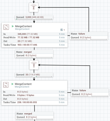

In cases like this I recommend doing a two phase merge with multiple MergeContent processors.
I would configure first MergeContent to merge based on min (15000) and max (20000) number entries. You should also set a max bin age. You will need to make sure you push up your connection object threshold from 10000 to 20000.
The second MergeContent Processor would then be set to merge based on min (120 MB) and max (128 MB) group size. You should also set a max bin age.
The result of which will be far less heap usage but the same desired end result.
The flow would look something like this:
