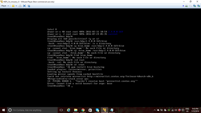

@Benjamin Leonhardi I tried to install thru "yum install hive-hcatalog"
Please find the attached screenshot
Master Guru
Are you using HDP? Then you would install them through Ambari. Host-> Add Client
