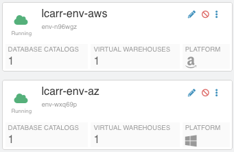

Figure 1: Environments Used.

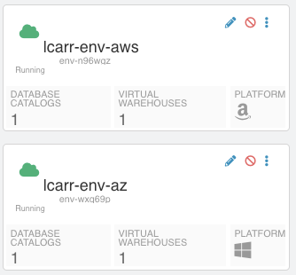

After the environment automatic setup, we can activate in Cloudera Data Warehouse:
Figure 2: Environments activated on Cloudera Data Warehouse experience.

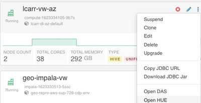

First access Hue on Azure Cloudera Data Warehouse on Cloudera Data Warehouse UI and execute the next steps:
Figure 5: Open Hue in Azure Cloudera Data Warehouse

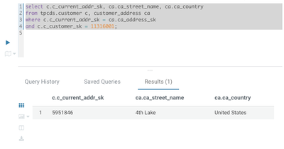

Now we can perform the select for the registry that we want to change:
select c.c_current_addr_sk, ca.ca_street_name, ca.ca_country
from tpcds.customer c, customer_address ca
where c.c_current_addr_sk = ca.ca_address_sk
and c.c_customer_sk = 11316001;
Figure 6: Address that we want to change.

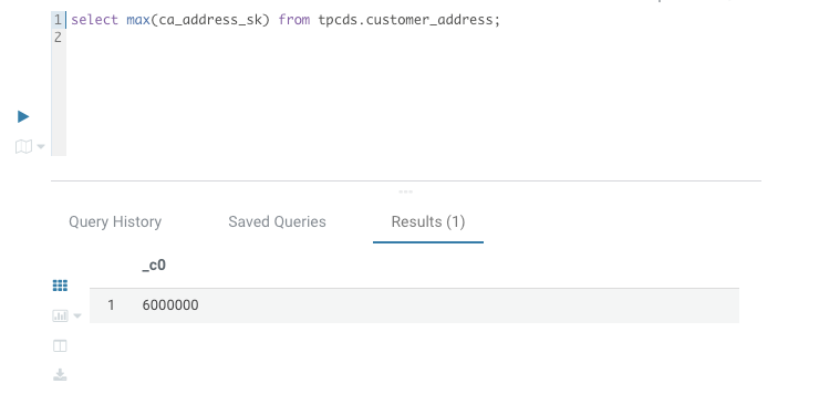

First, we will insert a new register on the customer_address table. For this, we need to find the last number registered so we won't collide with any current address:
Figure 7: Max ID

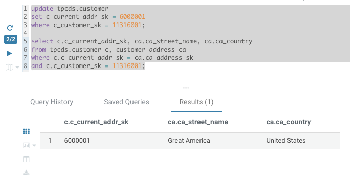

And after this, we can update the customer information with the new id and check it with the same query that we've run first:
Figure 8: Updated Address in Azure

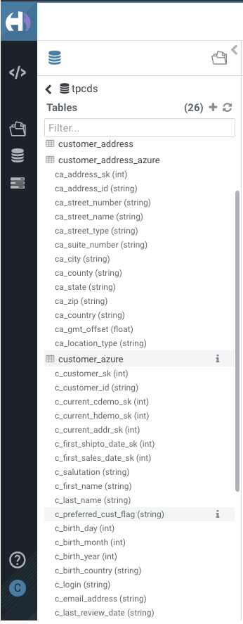

2.2 - Create the External JDBC Table to connect from AWS Cloudera VW to Azure Cloudera VW
Now that we have the data on Azure, let's access Cloudera Data Warehouse created on AWS in Hue using the same method that we've accessed Hue in Azure with.
In this example, we've already the same schema/tables created in this environment with the data stored in S3 instead ADLS.
Figure 9: Schema of tables in AWS Cloudera Environment

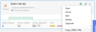

For this step, we need the Azure Virtual Warehouse JDBC address, we can get in Cloudera Data Warehouse UI in the Copy JDBC URL button:
Figure 10: Copy JDBC URL from Azure Cloudera Virtual Warehouse
Now we can execute the following script to create the JDBC tables (please change the "hive.sql.jdbc.url" value with the JDBC address from your Virtual Warehouse. Also change the user/password with your CDP user/password:
use tpcds;
CREATE TABLE `customer_azure`(
  `c_customer_sk` int,
  `c_customer_id` string,
  `c_current_cdemo_sk` int,
  `c_current_hdemo_sk` int,
  `c_current_addr_sk` int,
  `c_first_shipto_date_sk` int,
  `c_first_sales_date_sk` int,
  `c_salutation` string,
  `c_first_name` string,
  `c_last_name` string,
  `c_preferred_cust_flag` string,
  `c_birth_day` int,
  `c_birth_month` int,
  `c_birth_year` int,
  `c_birth_country` string,
  `c_login` string,
  `c_email_address` string,
  `c_last_review_date` string)
STORED BY 'org.apache.hive.storage.jdbc.JdbcStorageHandler'
TBLPROPERTIES (
  "hive.sql.database.type" = "MYSQL",
  "hive.sql.jdbc.driver" = "org.apache.hive.jdbc.HiveDriver",
  "hive.sql.jdbc.url" = "<CHANGEMEwithJDBC>",
  "hive.sql.dbcp.username" = "<CDPUSERNAME",
  "hive.sql.dbcp.password" = "<CDPWORKLOADPASSWORD>",
  "hive.sql.query" = "SELECT c_customer_sk, c_customer_id, c_current_cdemo_sk, c_current_hdemo_sk, c_current_addr_sk, c_first_shipto_date_sk, c_first_sales_date_sk, c_salutation, c_first_name, c_last_name, c_preferred_cust_flag, c_birth_day, c_birth_month, c_birth_year, c_birth_country, c_login, c_email_address, c_last_review_date_sk from tpcds.customer",
  "hive.sql.dbcp.maxActive" = "1"
CREATE TABLE `customer_address_azure`(
  `ca_address_sk` int,
  `ca_address_id` string,
  `ca_street_number` string,
  `ca_street_name` string,
  `ca_street_type` string,
  `ca_suite_number` string,
  `ca_city` string,
  `ca_county` string,
  `ca_state` string,
  `ca_zip` string,
  `ca_country` string,
  `ca_gmt_offset` float,
  `ca_location_type` string)
TBLPROPERTIES (
  "hive.sql.query" = "SELECT ca_address_sk,ca_address_id,ca_street_number,ca_street_name,ca_street_type,ca_suite_number,ca_city,ca_county,ca_state,ca_zip,ca_country,ca_gmt_offset,ca_location_type from tpcds.customer_address",
Figure 11: Azure JDBC Tables created in AWS Cloudera Virtual Warehouse

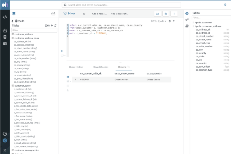

Now we can query these tables in AWS Cloudera Virtual Warehouse:
from tpcds.customer_azure c, tpcds.customer_address_azure ca
and c.c_customer_sk = 11316001;​
Figure 12: Results from Azure Cloudera DW environment in AWS Cloudera DW Environment.
Just to validate, we can run the same query in AWS Cloudera environment with the original tables. We can see that the result is different:
Figure 13: Results from AWS Cloudera VW.

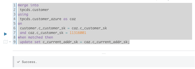

First, we will update the AWS customer table based on the results of the customer_azure table:
use tpcds;
merge into
 tpcds.customer
using
 tpcds.customer_azure as caz
on
 customer.c_customer_sk = caz.c_customer_sk
 and caz.c_customer_sk = 11316001
when matched then
 update set c_current_addr_sk = caz.c_current_addr_sk;
Figure 14: Updating Customer table in Cloudera AWS Data Warehouse using Azure Cloudera Data Warehouse as source

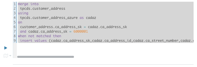

Note that we are not inserting a register in case it's not matched, and we're not updating other fields since we only want to demonstrate the address in this example, but this is completely possible. Also, in the WHERE clause, we're defining the customer_sk to match to one register, just for this example.
merge into
using
 tpcds.customer_address_azure as cadaz
on
 customer_address.ca_address_sk = cadaz.ca_address_sk
 and cadaz.ca_address_sk = 6000001
when not matched then
 insert values (cadaz.ca_address_sk,cadaz.ca_address_id,cadaz.ca_street_number,cadaz.ca_street_name,cadaz.ca_street_type,cadaz.ca_suite_number,cadaz.ca_city,cadaz.ca_county,cadaz.ca_state,cadaz.ca_zip,cadaz.ca_country,cadaz.ca_gmt_offset,cadaz.ca_location_type);
Figure 15: Insert new data into Customer Address table in Cloudera AWS Data Warehouse using Azure Cloudera Data Warehouse as source.

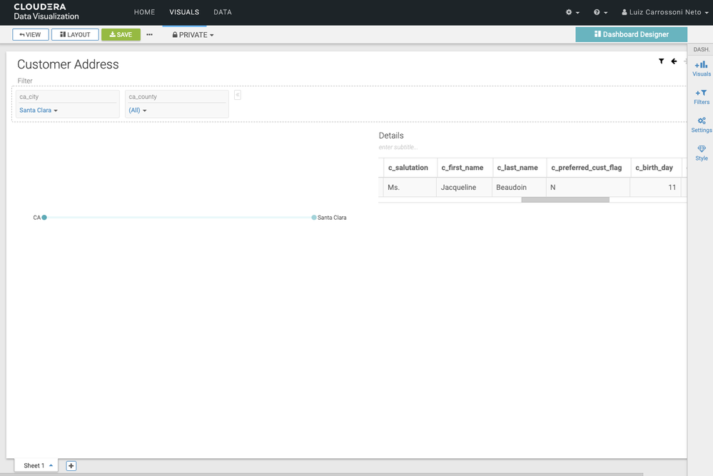

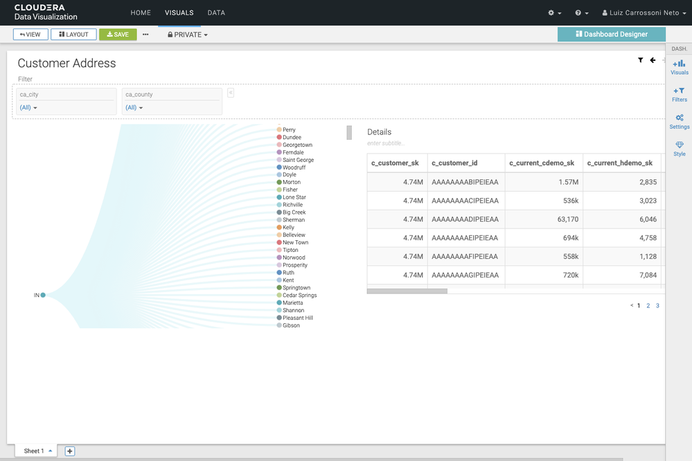

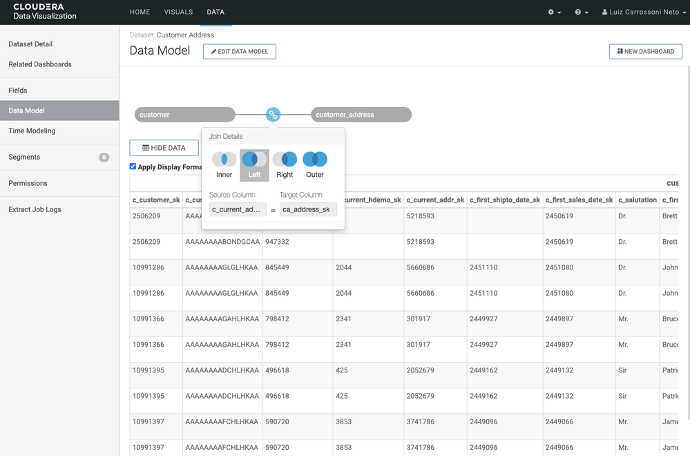

5. Bonus: Using Impala and Cloudera Viz to present the ACID Data
With Cloudera Viz in an Impala Cloudera Virtual Warehouse using the same AWS environment that we've used on the steps above, we can create the model:
Figure 17: Data modeling on Cloudera VIZ under an Impala AWS Data Warehouse
Creating the Dashboard is pretty easy since we can use the options that Viz show automatically based on data types:
Figure 18: Dashboard Customer Address Creation.
And we can filter the data to see if the city that we've added is there:
carrossoni_18-1623358146568.pngFigure 19: Updated ACID data read via Impala.
