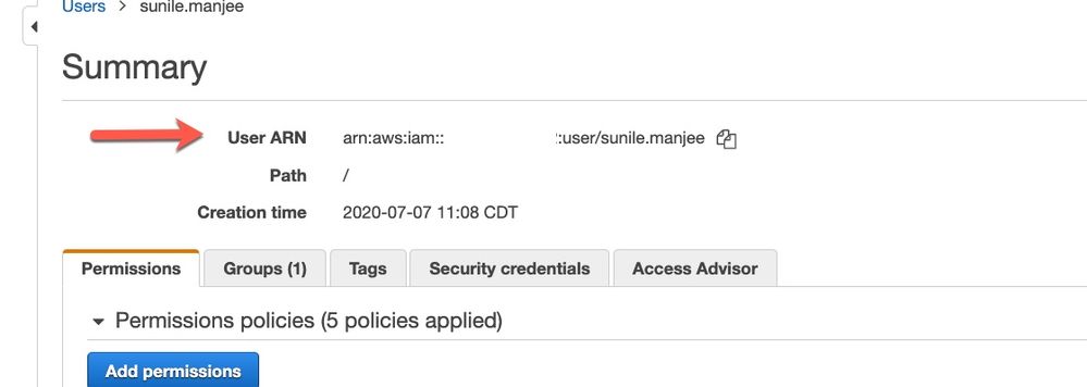

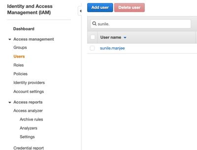

  1. On AWS, go to IAM > Users > Search for your user name:2020-08-12_10-49-45.jpg
  2. Click on your username to fetch the ARN:2020-08-12_10-49-57.jpg

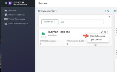

  1. Connecting to DW-X using K9s requires kubeconfig. DW-X makes this available under DW-X-> Environments > Your Environment > Show Kubeconfig.
  2. Click on the copy option and make the contents available within a file in your machine file system.  For example, I stored the kubeconfig contents here:
    /Users/sunile.manjee/.k9s/kubeconfig.yml​

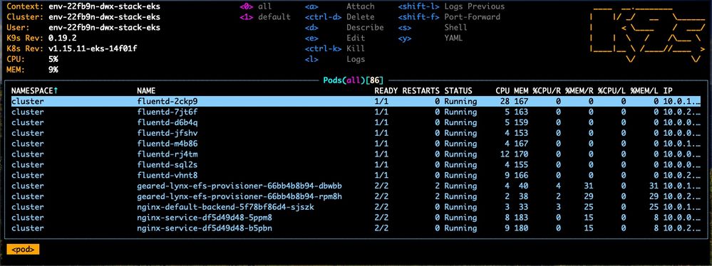

Now all is set up to connect to DW-X K8s using K9s.   Reference kubeconfig.yml file when using K9s
k9s --kubeconfig /Users/sunile.manjee/.k9s/kubeconfig.yml
That's it. From here the logs are made available and a ton of other metrics.  For more information on how to use K9s, see k9scli.io
