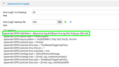

Default configuration:
To automatically compress the rolled over log files, update the highlighted line to:
appender.DRFA.filePattern = ${sys:hive.log.dir}/${sys:hive.log.file}.%d{yyyy-MM-dd}-%i.gz
-%i will ensure that in a rare scenario when there has been increased logging and the threshold size can be been reached more than once in the specified interval, the previously rolled over file won't get over written.
.gz will ensure that files are compressed using gzip

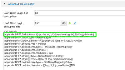

Similarly you can also make similar changes to llap-cli log settings:
