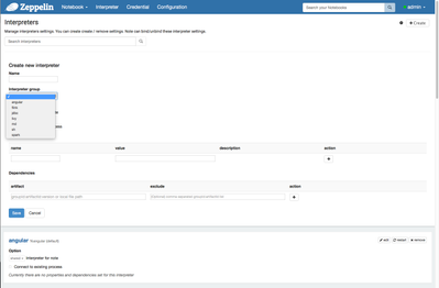

If you try to add the interpreter, you will see it is not in the list. You should see something similar to:

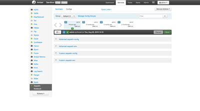

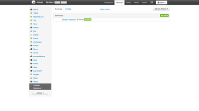

Click on the Zeppelin Notebook service in Ambari:
Now, click on the Configs link:

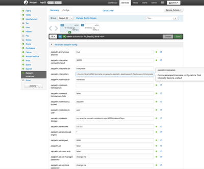

Expand Advanced zeppelin-config:
Add the following string to the end of the zeppelin.interpreters parameter:
,org.apache.zeppelin.elasticsearch.ElasticsearchInterpreter
Note: The comma is not a typo. It is required to seperate our added value from the previous value.
It should look similar to this:
Now click the Save button to save the settings. You should see an indication that you need to restart the Zeppelin service. It should look similar like this:
Restart the Zeppelin Notebook service.

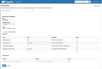

Configure Zeppelin Interpreter
Now you should be able to follow the documentation I linked previously for setting up the Elasticsearch interpreter. You should have something similar to this:
The elasticsearch.host value will correspond to your ip address or sandbox.hortonworks.com if you have edited your local /etc/hosts file.

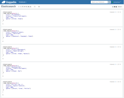

Now we are going to create a notebook in Zeppelin. You should have a note for each index operation in the notebook. Let's use the %elasticsearch and the index command to index some data:
%elasticsearch
index movies/default/1 {
    "title": "The Godfather",
    "director": "Francis Ford Coppola",
    "year": 1972,
    "genres": ["Crime", "Drama"]
%elasticsearch
index movies/default/2 {
    "title": "Lawrence of Arabia",
    "director": "David Lean",
    "year": 1962,
    "genres": ["Adventure", "Biography", "Drama"]
%elasticsearch
index movies/default/3 {
    "title": "To Kill a Mockingbird",
    "director": "Robert Mulligan",
    "year": 1962,
    "genres": ["Crime", "Drama", "Mystery"]
%elasticsearch
index movies/default/4 {
    "title": "Apocalypse Now",
    "year": 1979,
    "genres": ["Drama", "War"]
%elasticsearch
index movies/default/5 {
    "title": "Kill Bill: Vol. 1",
    "director": "Quentin Tarantino",
    "year": 2003,
    "genres": ["Action", "Crime", "Thriller"]
%elasticsearch
index movies/default/6 {
    "title": "The Assassination of Jesse James by the Coward Robert Ford",
    "director": "Andrew Dominik",
    "year": 2007,
    "genres": ["Biography", "Crime", "Drama"]
You should have a notebook that looks similar to this:
For each of the index notes, click the play button to insert the data.
