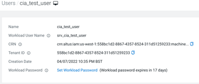

To work with Datahub Spark in CDP we need a machine user to run the queries.

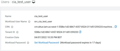

Creating a machine user
For this demo, we will use a Machine User, created inside CDP as the user running queries. Inside CDP > User Management, add a new Machine User and set the workload password.
The steps for this are documented here:
  1. Creating a Machine User
  2. Setting the workload password
With the machine user created and the workload password set, take a note of the Workload User Name & Workload Password. Notice in the below screenshot, that for a Machine User called ‘cia_test_user’ the workload username is ‘srv_cia_test_user’.
Note: Keep the Workload User Name & Workload Password details handy for later.

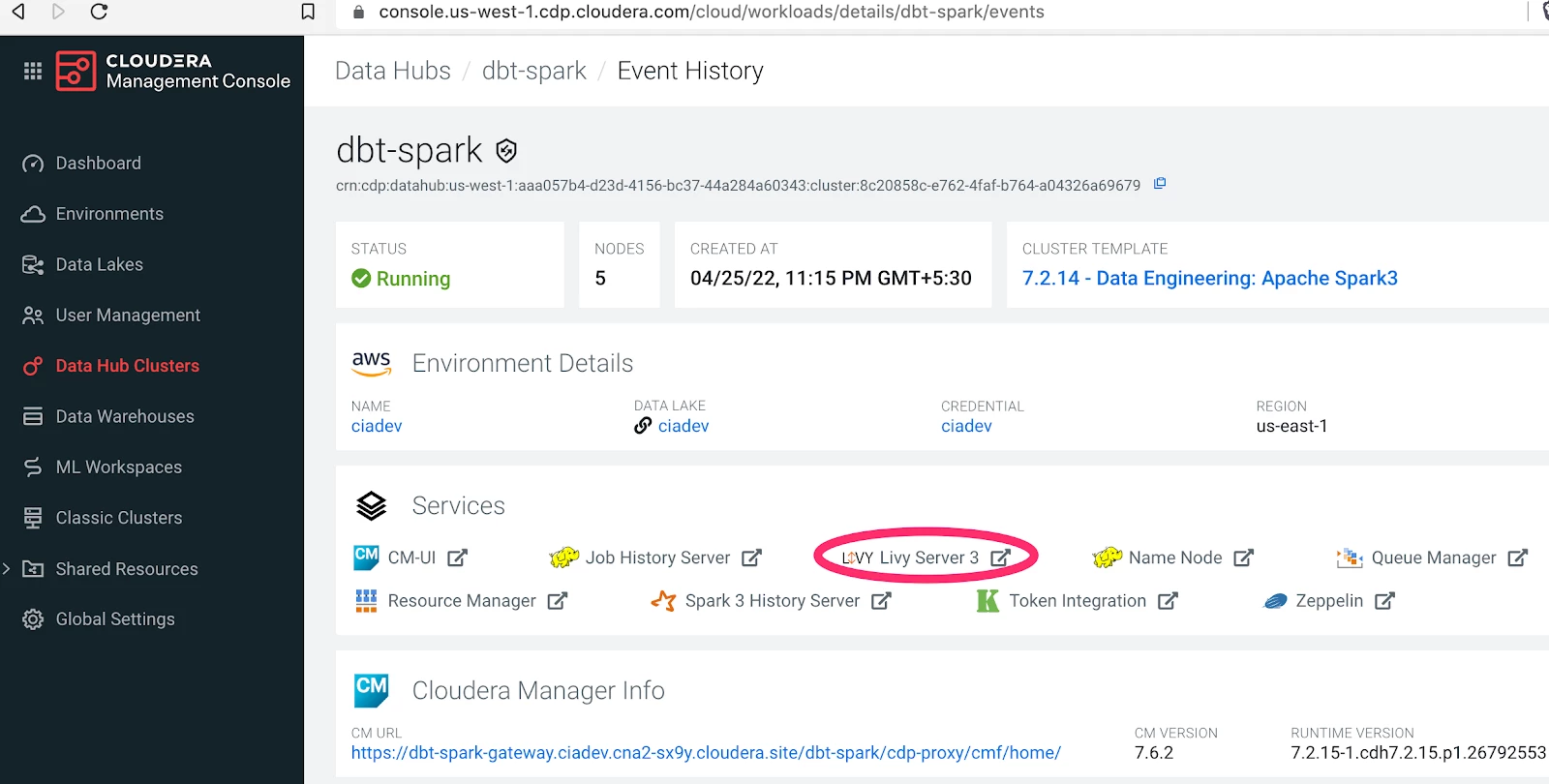

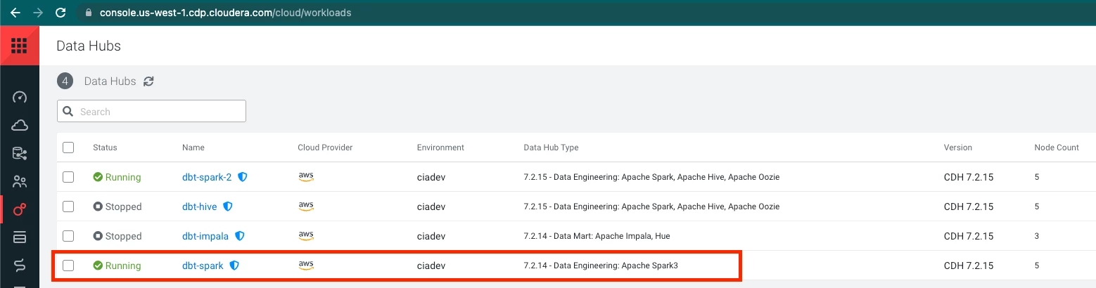

  2. For our use case, we choose a cluster that provides Spark. We went with 7.2.14 - Data Engineering: Apache Spark3. You can choose one of the default available clusters that includes spark, livy, and hive services to create this data hub or customize your own cluster. Once up and running you should have a datahub cluster similar to the below. CIA_1-1657577794720.png
    Note: The steps are similar if you create a data hub providing Apache Spark(spark v2) as the service instead of spark3 (spark v3).

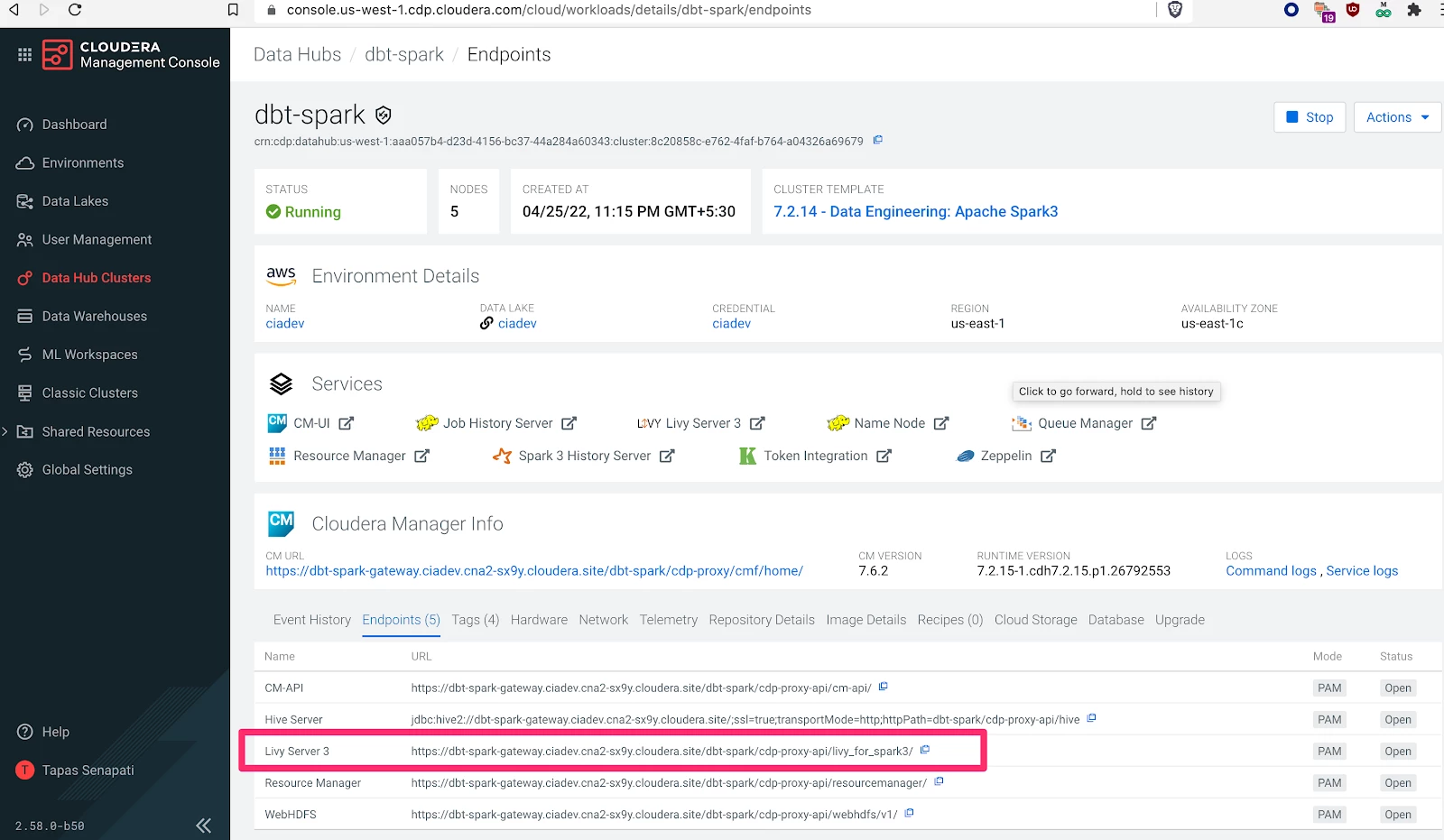

  3. With the data hub cluster in running state, you can view the details of the Data Hub by clicking on it. The livy server UI and other relevant addresses are accessible from the same page.
  4. Go to Endpoints and note down the Livy Server 3/Livy server endpoint depending on your version of the spark that you used to create the datahub cluster. This is the endpoint dbt will be connecting to

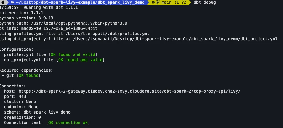

To ensure we’ve configured our profile correctly, run a connection test. In the project directory, for us dbt_spark_livy_demo run the following command:
dbt debug
In the output of this command, you should see the following: All checks passed similar to this.

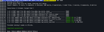

Loading fake data

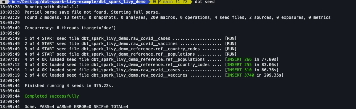

  1. To run the seeds, move to our dbt project dbt_spark_livy_demo inside our cloned project dbt-spark-livy-example and run the following command:
    dbt seed
  2. The terminal should look like this:
  3. This will load the reference data into the warehouse. Users can visualize this through hue UI

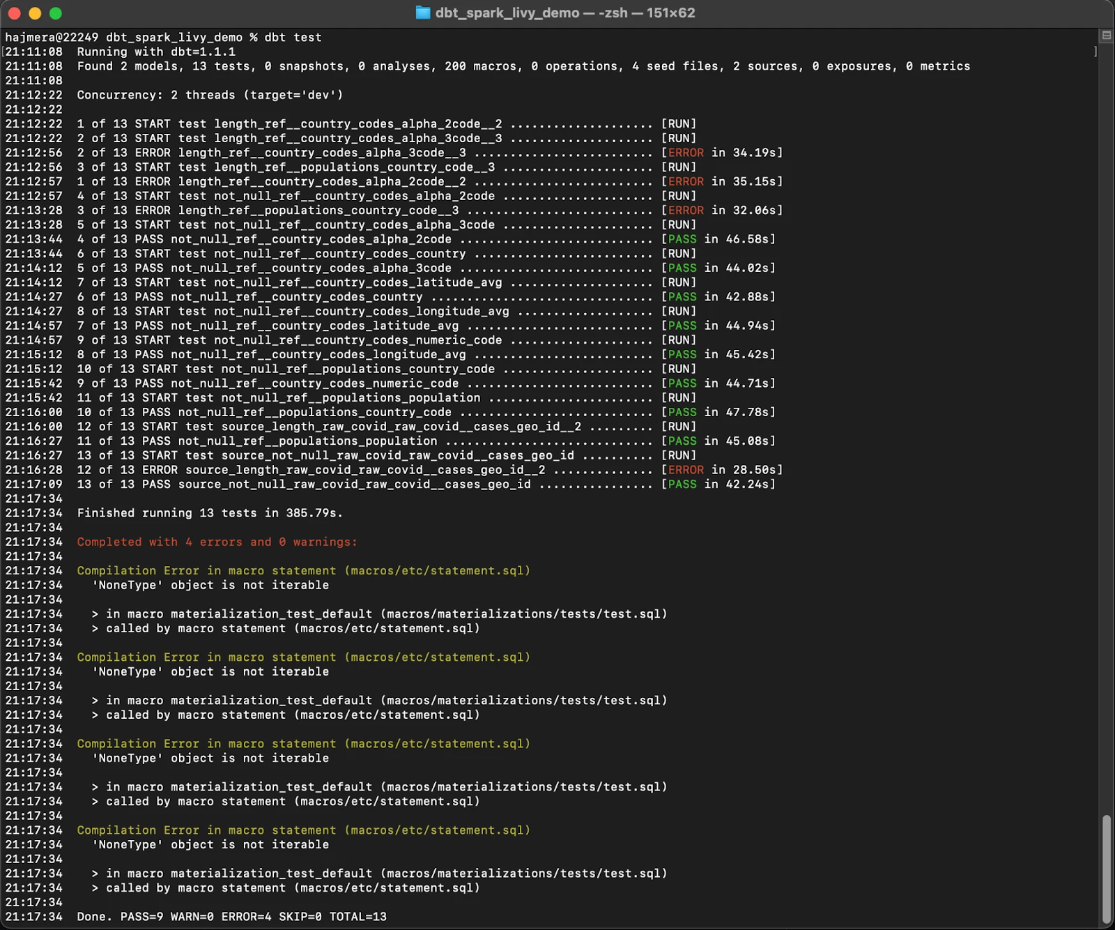

  1. Run the following command to tests:
    dbt test
  2. The terminal should look something like this. Don’t be concerned about the errors::

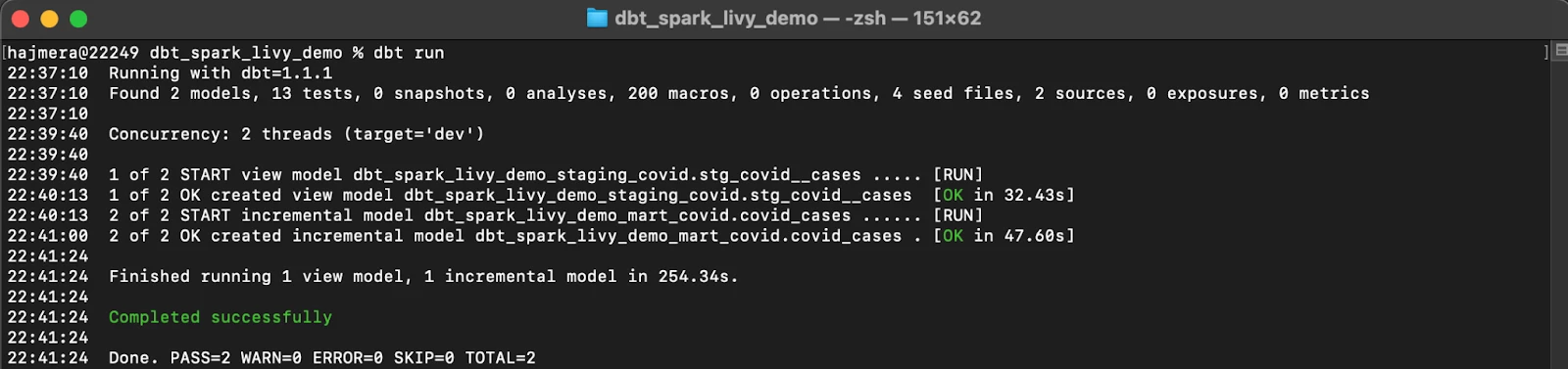

  1. Run models with the following commands:
    dbt run

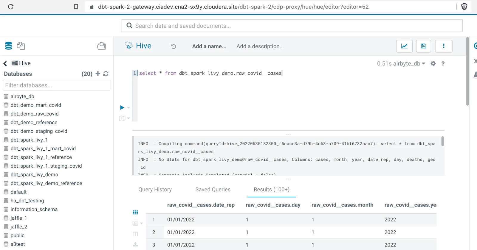

Reviewing the data and models
Reviewing the database and table in Hue UI
User should now have the following databases & tables:
  • reference (database)
    • ref__population (table)
    • ref__country_codes (table)
  • raw_covid (database)
    • raw_covid__vaccines (table)
    • raw_covid__cases (table)
  • staging_covid (database)
    • stg_covid__cases (view)
  • mart_covid (database)
    • covid_cases (table)
In the raw, staging, and mart tables, you should see 2 days' worth of data for the dates 01/01/2022 and 02/01/2022. You can generate more fake data and play around.

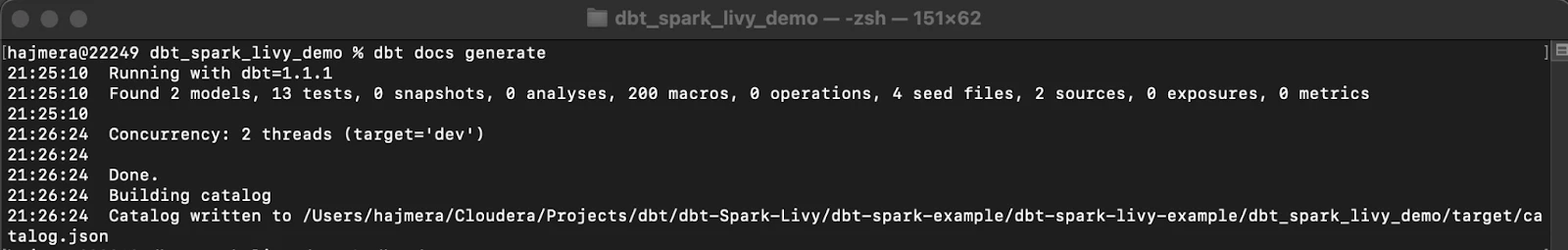

Generating and viewing dbt documentation:
  1. Run the following command to generate the documentation:
    dbt docs generate
  3. Users can read more about dbt docs here

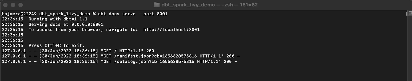

  4. Run the following command to open the documentation on the browser:
    dbt docs serve –port 8001
    The dbt docs serve command is only intended for local/development hosting of the documentation site.  You can view it locally through http://localhost:8001/  or the port number you used to create the dbt docs serve.
  5. The terminal should look like this:
