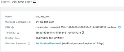

For this demo, we will use a Machine User created inside CDP as the user running queries. Inside CDP > User Management, add a new Machine User and set the workload password.
The steps for this are documented here:
  1. Creating a Machine User
  2. Setting the workload password
With the user created & the workload password set, take a note of the Workload username & password. Notice in the below screenshot, that for a Machine User called ‘cia_test_user’ the workload username is ‘srv_cia_test_user’.
Keep the workload user & password details handy for later.

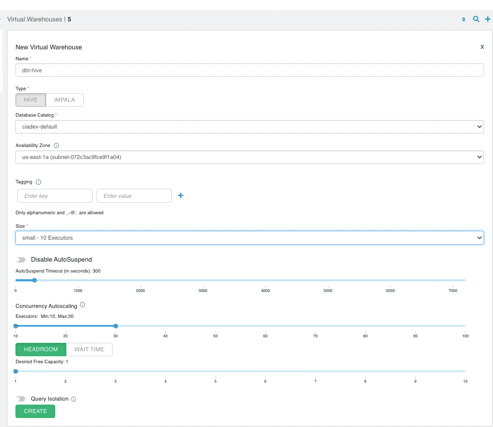

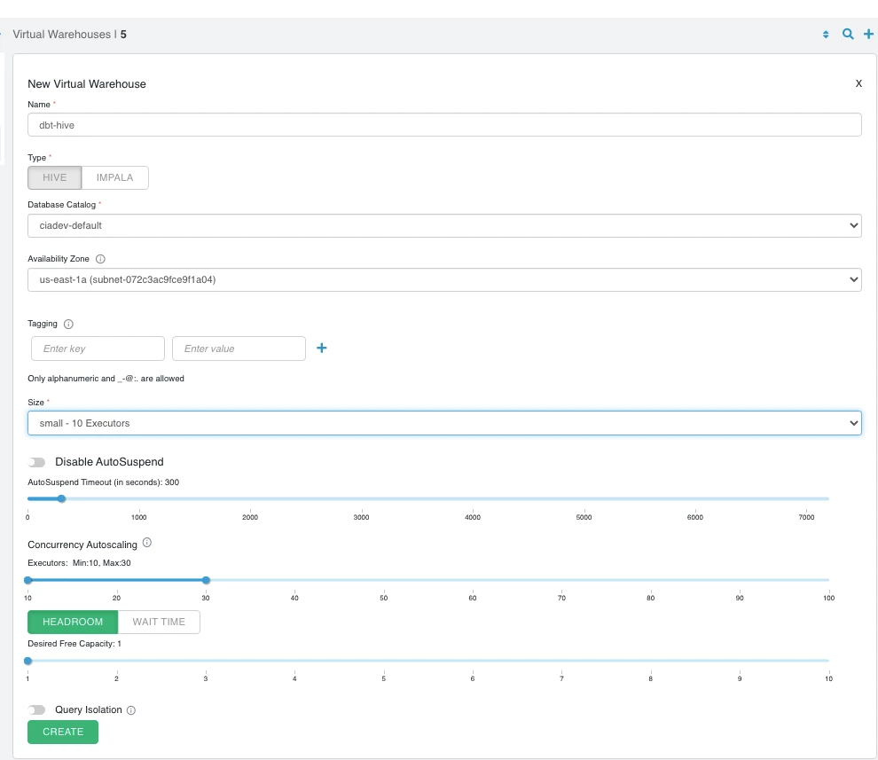

The following settings will be used for Hive Virtual Warehouse in this demo:

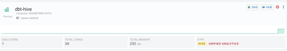

Once created, you should see that the Virtual Warehouse enters the running state

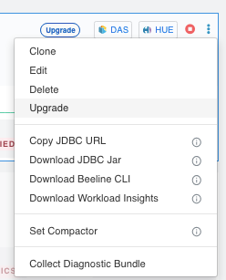

From here, select the 3 dots, and then Copy JDBC URL. In my case, this looks like this:
jdbc:hive2://hs2-dbt-hive.dw-ciadev.cna2-sx9y.cloudera.site/default;transportMode=http;httpPath=cliservice;socketTimeout=60;ssl=true;retries=3;
Keep this URL handy for later.

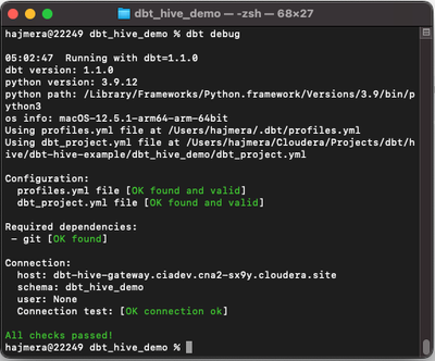

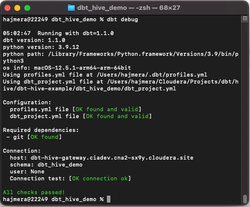

To ensure we’ve configured our profile correctly, run a connection test. In the project directory, for us dbt_hive_demo run the following command:
dbt debug
In the output of this command, you should see the following:
All checks passed similar to this.

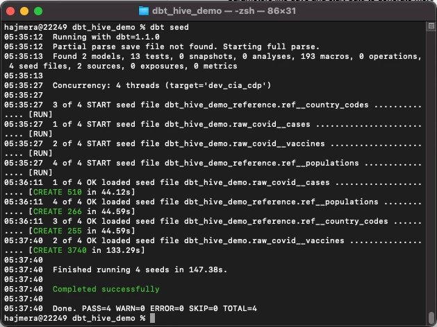

To run the seeds, move to our dbt project dbt_hive_demo inside our cloned project dbt-hive-demo and run the following command:
dbt seed
The terminal should look like this:
This will load the reference data into the warehouse. User can visualize this through hue UI

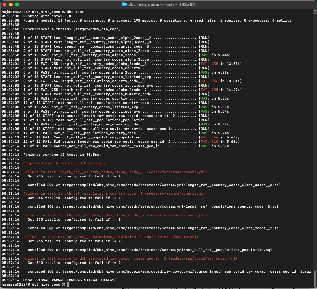

Run the following command to tests:
dbt test
The terminal should look something like this. Don’t be concerned about the errors.hajmera_6-1661494527373.png

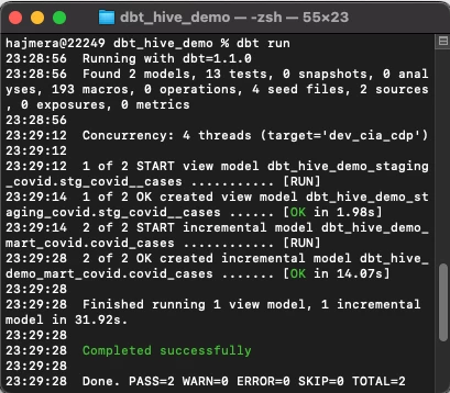

  1. Run models with the following commands:
    dbt run
  2. The terminal should look like this:

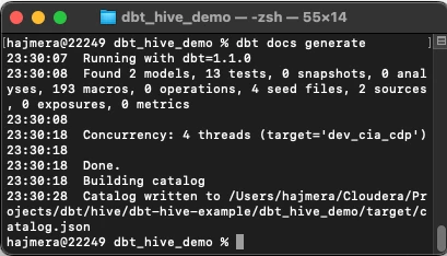

Generating and viewing dbt documentation:
  1. Run the following command to generate the documentation:
    dbt docs generate
  3. Users can read more about dbt docs here

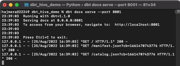

  4. Run the following command to generate the documentation:
    dbt docs serve --port 8001
    The dbt docs serve command is only intended for local/development hosting of the documentation site.  You can view it locally through http://localhost:8001/  or the port number you used to create the dbt docs serve.
  5. The terminal should look like this:
