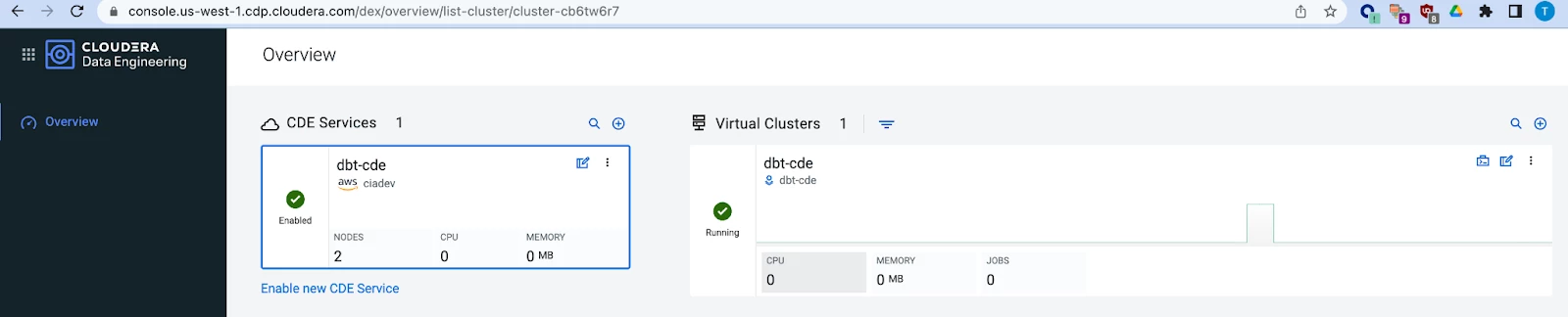

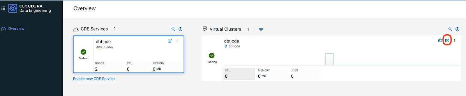

Create Cloudera Data Engineering Cluster
Once you have an environment with CDE enabled the next step is to create a virtual cluster that can be used to run the spark jobs. You may create as many virtual clusters as you want. To create a virtual cluster you can refer to the link
https://docs.cloudera.com/data-engineering/cloud/manage-clusters/topics/cde-create-cluster.html
Once you have the CDE environment enabled and virtual cluster setup you should see something similar to this in your CDE overview page

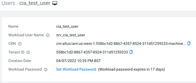

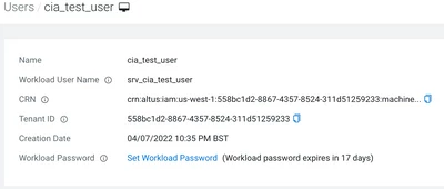

Step 1. Creating a machine user
For this demo, we will use a Machine User, created inside CDP as the user running queries. Inside CDP > User Management, add a new Machine User and set the workload password.
The steps for this are documented here:
  1. Creating a Machine User
  2. Setting the workload password
With the user created and the workload password set, take a note of the Workload User Name & Workload Password. Notice in the below screenshot, that for a Machine User called ‘cia_test_user’ the workload username is ‘srv_cia_test_user’.
Note: Keep the Workload User Name & Workload Password details handy for later.

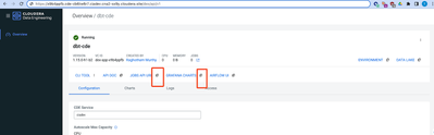

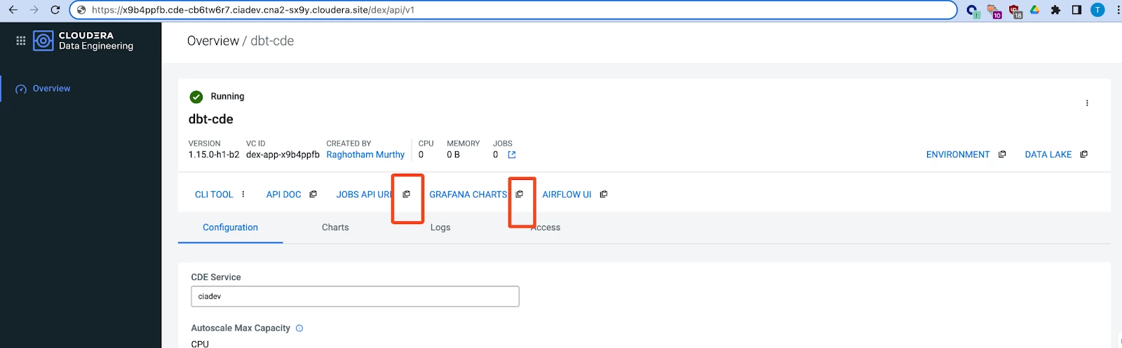

  1. Navigate to the Cloudera Data Engineering Overview page by clicking the Data Engineering tile in the Cloudera Data Platform (CDP) management console.
  2. In the Services column, select the environment containing the virtual cluster you want to interact with.
  3. In the Virtual Clusters column on the right, click the Cluster Details icon(highlighted in red) on the virtual cluster you want to interact with.
  4. Click the link next to GRAFANA CHARTS. The hostname of the URL before /grafana/d… in your browser is the base URL.
    E.g. https://service.cde-cb6tw6r7.ciadev.cna2-sx9y.cloudera.site/ is the base URL or authend_endpoint. Note it down.
  5. Next, click the link next to the jobs API URL. This is our host endpoint. Note it down. E.g. https://x9b4ppfb.cde-cb6tw6r7.ciadev.cna2-sx9y.cloudera.site/dex/api/v1hajmera_3-1658338315221.png

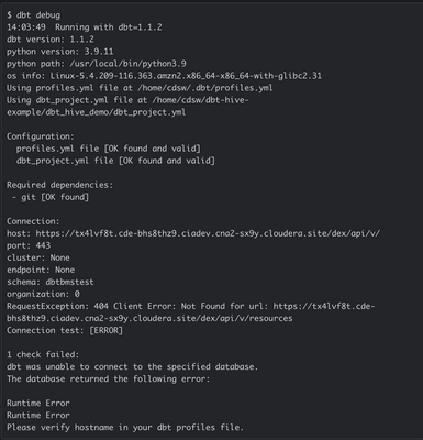

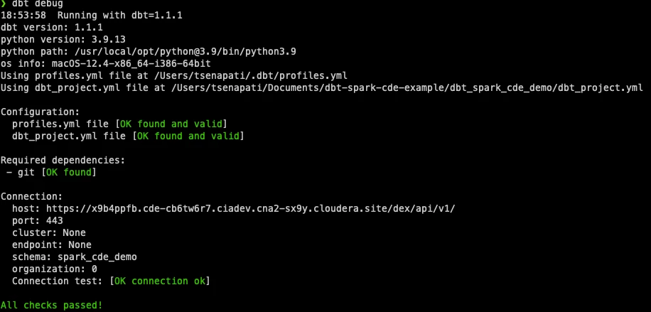

dbt debug
In the output of this command, you should see the following: All checks passed similar to this.

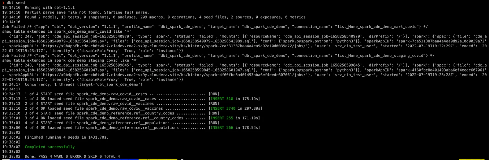

Loading fake data
  1. To run the seeds, move to our dbt project dbt_spark_cde_demo inside our cloned project dbt-spark-cde-example and run the following command:
    dbt seed
  2. The terminal should look like this:
  3. This will load the reference data into the warehouse.

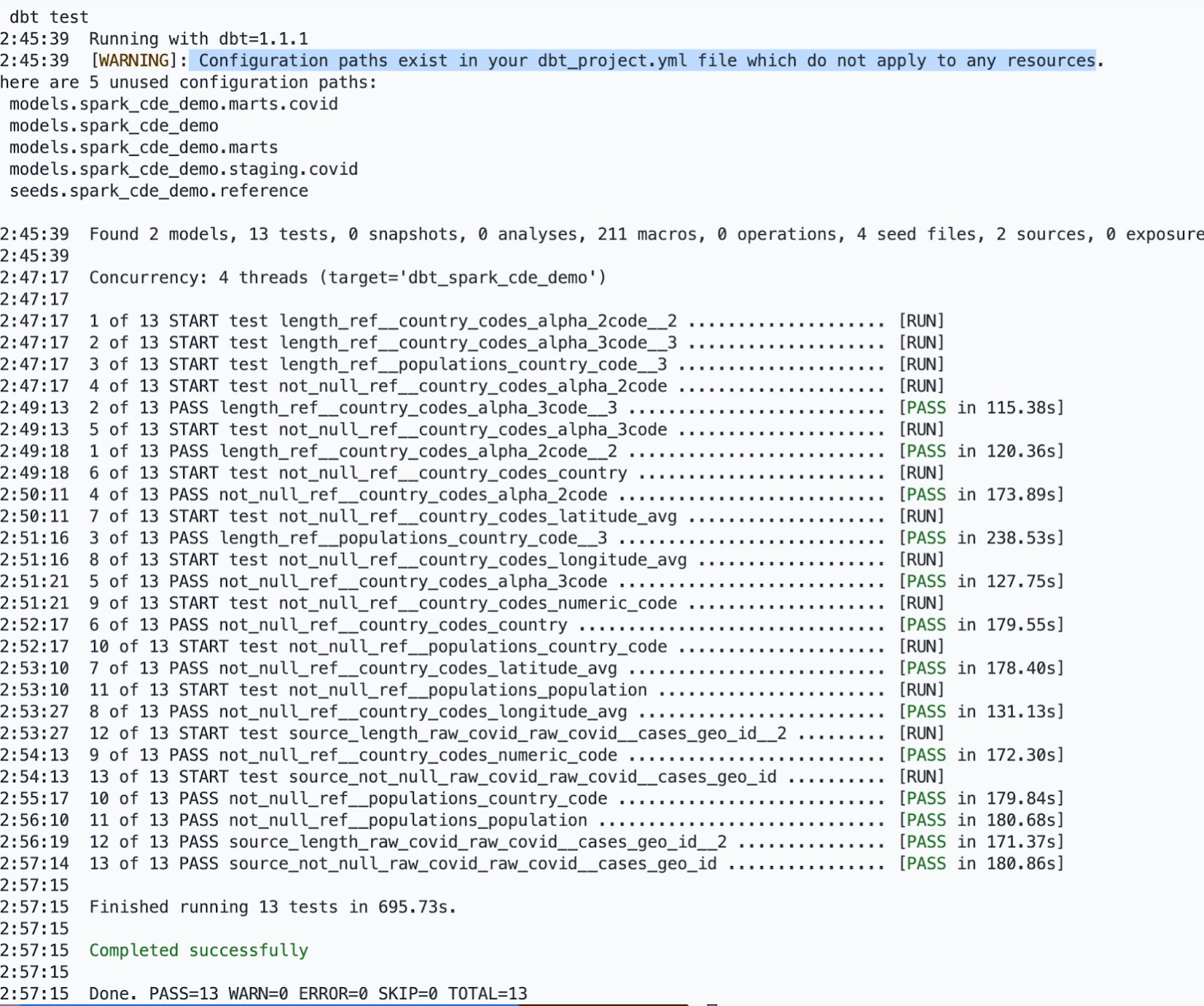

  1. Run the following command to tests:
    dbt test
  2. The terminal should look something like this. Don’t be concerned about the errors:

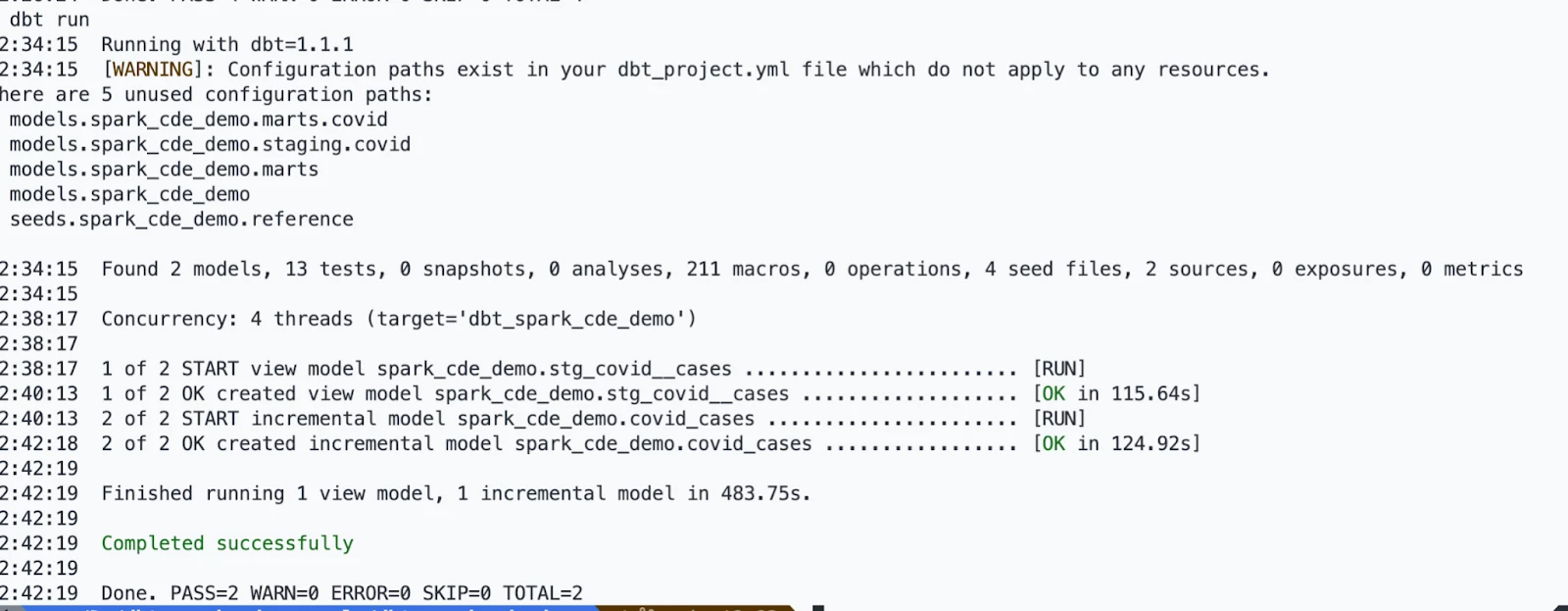

  1. Run models with the following commands
    dbt run

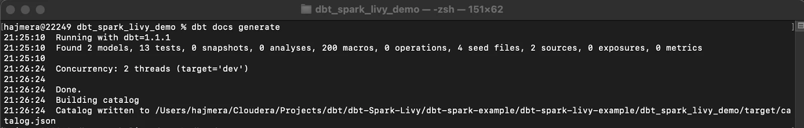

  1. Run the following command to generate the documentation:
    dbt docs generate

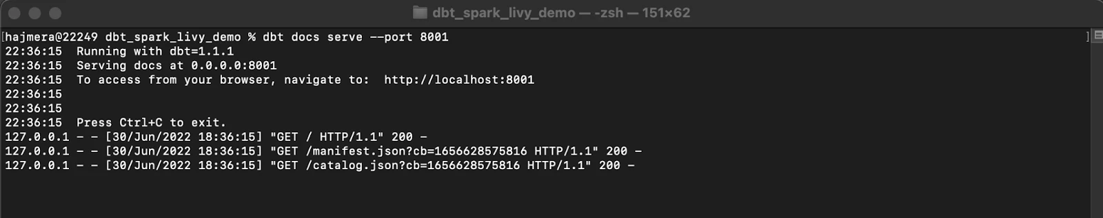

  4. Run the following command to open the documentation on the browser:
    dbt docs serve –port 8001
    The dbt docs serve command is only intended for local/development hosting of the documentation site.  You can view it locally through http://localhost:8001/  or the port number you used to create the dbt docs serve.
  5. The terminal should look like this:

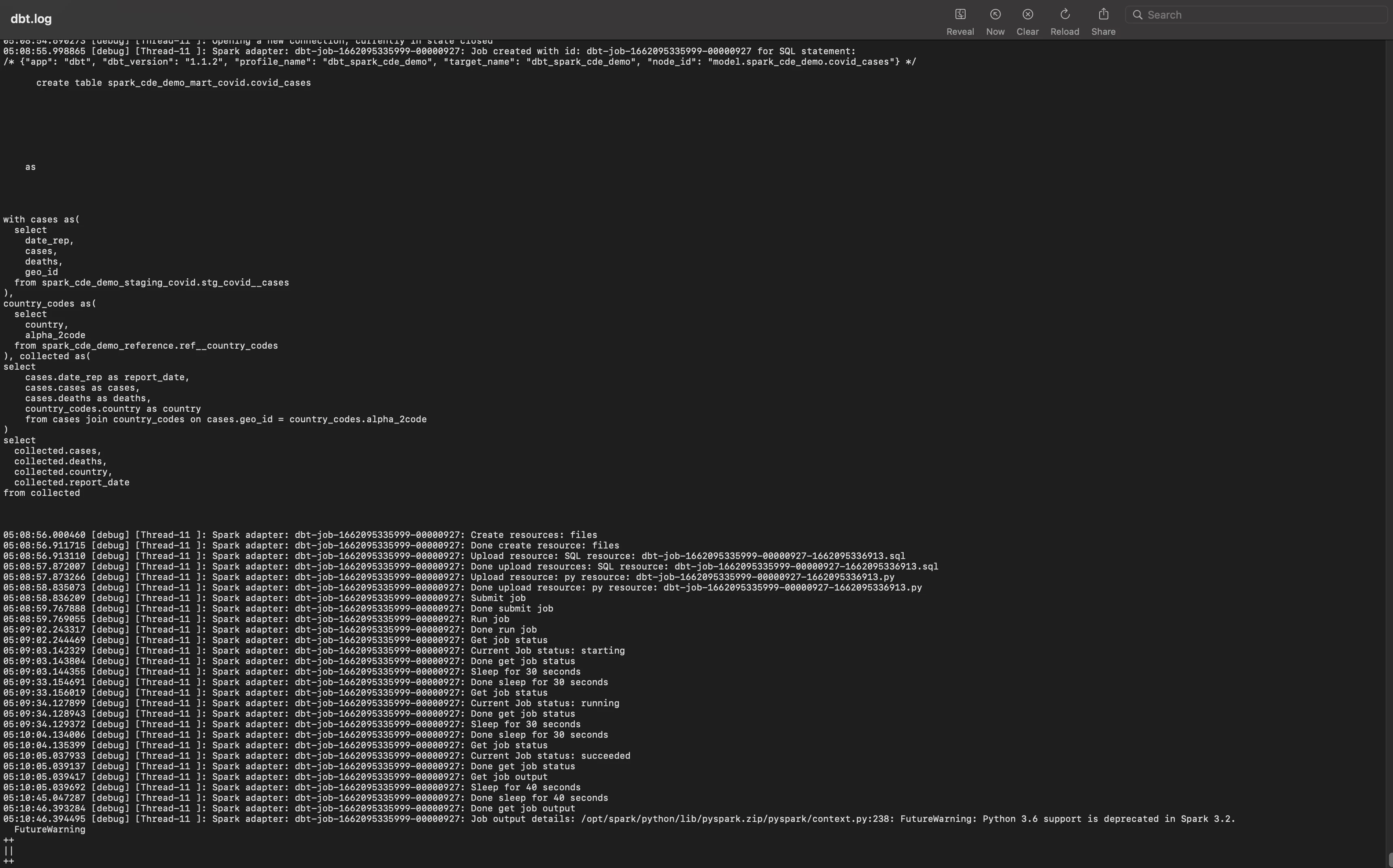

Debugging dbt job:
We have made code improvement to offer user friendly errors and logs.
  • Any dbt profiles errors or connection issues using dbt commands will show a user friendly messages:
  • Details for each query is now available in the logs like this sample file dbt.log:
    Such detailed log will help user to analyze the time taken by each job to execute the query with CDE.
