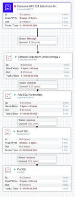

Once the data was sent a MQTT broker, it was easy to ingest with Apache NiFi.
  1. I ingest MQTT messages from the broker
  2. Extra Fields from the JSON File

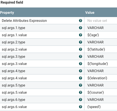

  3. Format some parameters for SQL
  4. build my SQL string
  5. then upsert into Phoenix/HBase.

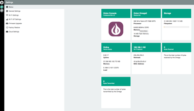

This is the beautiful Web Console that comes prerunning on the tiny Onion Omega2 device.
