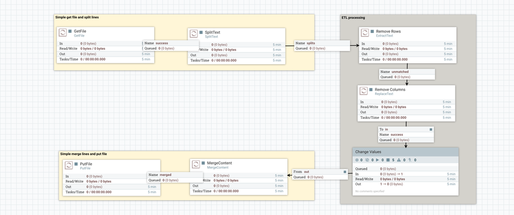

The Overall Flow
The overall flow is shown below, with the processors in gray doing the transformations.
Basic flow is:
  1. GetFile and SplitText feed records of a delimited file (e.g. csv) into the ETL processors.
  2. ExtractText filters out records (in my flow I match records to discard and flow the unmatched records)
  3. ReplaceText removes the same column(s) from the filtered records
  4. A processing group of ReplaceText processors changes values of fields in the record, based on specified condition(s)
  5. MergeContent and PutFile append the result into a single file.
Note that the data can be gotten from any source (not necessarily a file as shown here) and put to any source. The only requirement is that the lines inputted to the ETL processing subflow are delimited into the same number of fields (comma-separated, tab-separated, etc).

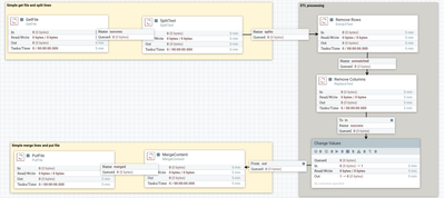

Extract the data and feed to transform processing9502-screen-shot-2016-11-16-at-20820-pm.png
I get the data from a file (you could fetch from another type of data store) and split the lines into a sequence of flow files fed to the transformations.

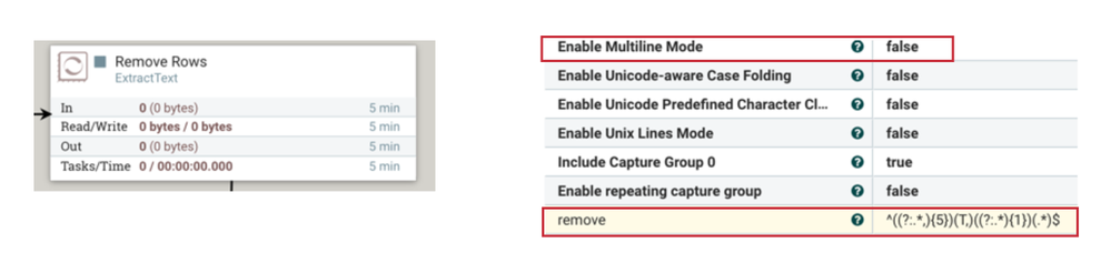

Filter Records
Records are filtered with the ExtractText processor. Recall that SplitText is feeding each record to this processor as a sequence of single files.
Key setting is the attribute "remove" that I have added. Any line that matches this regular expression will not be sent to the next processor (because the connection is to send unmatched). Note that if you want filter based on more conditions you can either expand the regex shown or added more attributes (which is an OR logic, any record satisfying one or more of the attributes added is considered matched).
As explained above, the regex shown will match any record with T as value in the 6th field.

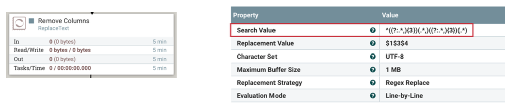

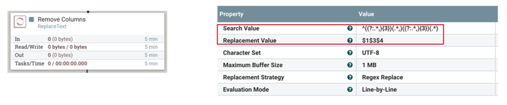

Remove Columns
Columns are removed with the ReplaceText processor.
As explained earlier, the Search Value regular expression defines 4 expression groups (the first 3 columns, the 4th column, the next 3 columns, and the last column. The Replacement Value says to keep the 1st, 3rd and 4 expression groups, thus dropping the 4th column.

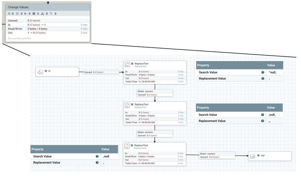

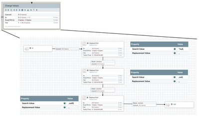

Replace Values
I use three ReplaceText Processors to replace field values for the first field (no delim before value), middle fields (delim before and after value) and last field (no delim after value). I use this to replace null with empty character. I also use a processor group to organize these conveniently.

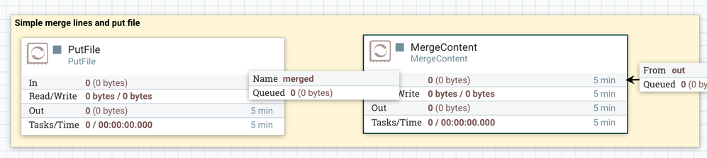

Load
I put the data to a file but you could load to any target. I use the default settings for these processors, except for the path data I specify for the target file.
