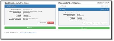

I already did created Certification Authorities and client certificates at www.tinycert.org
If you are too lazy to create them, try with mine 🙂 [Attached as certificates.zip]
- Use cert-browser.pfx to load into browser to be a NiFi administrator 'DEMO'
- Upload other two certificates to your server under '/root/scripts/' and execute below commands, while executing last command enter 'hadoop' as password and 'yes' when asked if it can be trusted.

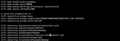

4. Once opened in editor update below properties to given values [updating https port and certificate details]:
nifi.web.http.host=
nifi.web.http.port=
nifi.web.https.host=node1
nifi.web.https.port=9090
nifi.security.keystore=/root/scripts/cert.p12
nifi.security.keystoreType=PKCS12
nifi.security.keystorePasswd=hadoop
nifi.security.keyPasswd=hadoop
nifi.security.truststore=/root/scripts/cacert.jks
nifi.security.truststoreType=JKS
nifi.security.truststorePasswd=hadoop

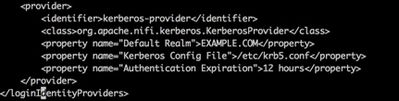

7. Configure ./conf/login-identity-providers.xml as below with reference to Kerberos Configured [Make sure you have removed xml comments tag].
<provider>
<identifier>kerberos-provider</identifier>
<class>org.apache.nifi.kerberos.KerberosProvider</class>
<property name="Default Realm">EXAMPLE.COM</property>
<property name="Kerberos Config File">/etc/krb5.conf</property>
<property name="Authentication Expiration">12 hours</property>
</provider>

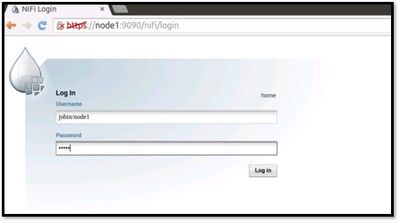

It will popup below screen for login, enter any of the credentials for identities we just created in step 7, “Configuring KDC”
Username: jobin/node1 Password: hadoop
Username: george/node1 Password: hadoop

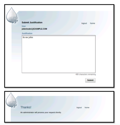

12. Enter the password as hadoop and hit login, enter justification and it will show up below screen that request is pending with Admin who already have access using certificates.

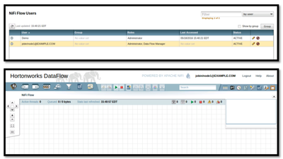

13. Now go back to chrome browser where ‘Demo’ user is NiFi Administrator and assign role to jobin.
14. Now you can see that the user is active:
15. Go back to the old session, as tom in safari, refresh the browser and you will be logged in as ‘jobin’ with privileges assigned by NiFi administrator. You can test if for other user ‘george’ as well.
Now you have Authenticated two users jobin and george to access NiFi User Interface.
