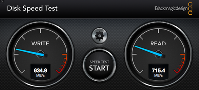

In this article, we’ll discuss tuning repository settings to achieve the highest possible throughput in MiNiFi C++. We’ll begin by benchmarking the SSD that we have. Based on reported numbers, the SSD in this 15” Macbook Pro is rated at 676 MB/s sequential write and 728 MB/s sequential read. Far from the highest, but our goal with this post is to achieve the highest possible throughput with the greatest guarantees. We’ll try different variations with and without volatile stores.
Our benchmark shows that we are achieving near optimal speeds across various runs.
