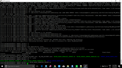

New Member
@Sourygna Luangsay I am unable to see tables in hive. The sqoop import seems to be successful.
New Member
Hive Import is Complete, but the next line gives the INFO hive.HiveImport: Export directory is contains the _SUCCESS file only, removing the directory.
I have made changes in the sqoop query as i am fetching data from Oracle.
When i log into hive the database doesn't has any tables, Please provide appropriate solution to this.
Hopeful to hear from you guys.
