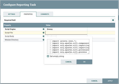

You will see a reporting task window. Select groovy as the Script Engine choice and paste the script below in Script Body. Make sure to change the location of the file where your events will be written to.

Click ok and apply. Click on the "Play " Button to active the reporting task. I had set the scheduling frequency for the task on mine to 10 secs, so i could see the results right away. You can set it to a higher value as needed.
You should the logs appear in /tmp/provenance.txt , in json format. you could use other formats if needed and also may be not prettify for better performance.
