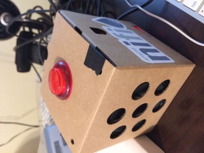

Using a Raspberry Pi 3 with Google AIY Voice Kit is an easy way to control data flows in an organization.
The AIY Voice Kit is a good way to prototype voice ingest. It is not perfect, but for low end inexpensive hardware it is a good solution for those that speak clearly and are willing to repeat a phrase a few times for activation.
I was able to easily add a word for it to react to. I also have it waiting for someone to press the button to activate.

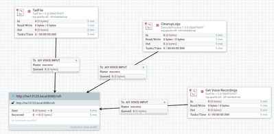

4. Download and Unzip Apache MiniFi
5. Custom Action controlx
6. Run it pi@raspberrypi:~/AIY-voice-kit-python/src $ ./controlx.py
7. start minifi
8. Apache MiniFi will tail the command file and look for audio files

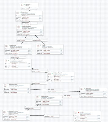

Apache NiFi Ingest Flow
Flow File for a Sound File
Flow File For Commands

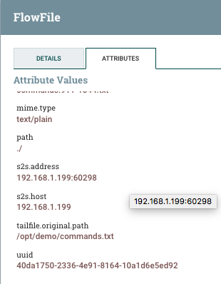

Apache MiniFi Ingest

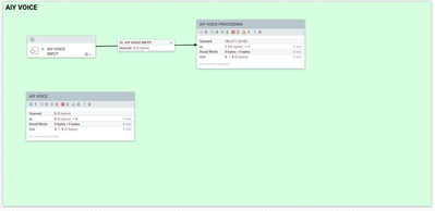

Apache NiFi Overview

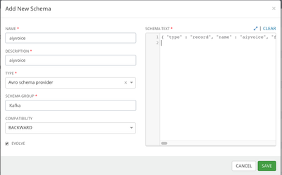

AIYVOICE Schema in Hortonworks Schema Registry

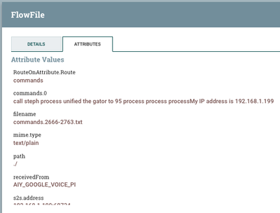

An example of text deciphered from my speaking into the AIY Voice Kit.
what was the process that we could try that a different way right now when was text put it in the file
My IP address is 192.168.1.199

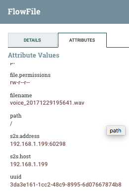

The Recorded Audio Files Sent
../images/voice_20171229195641.wav
../images/voice_20171229202456.wav
../images/voice_20171229203028.wav
