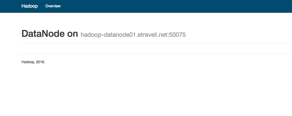

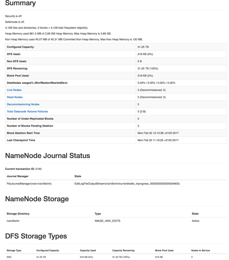

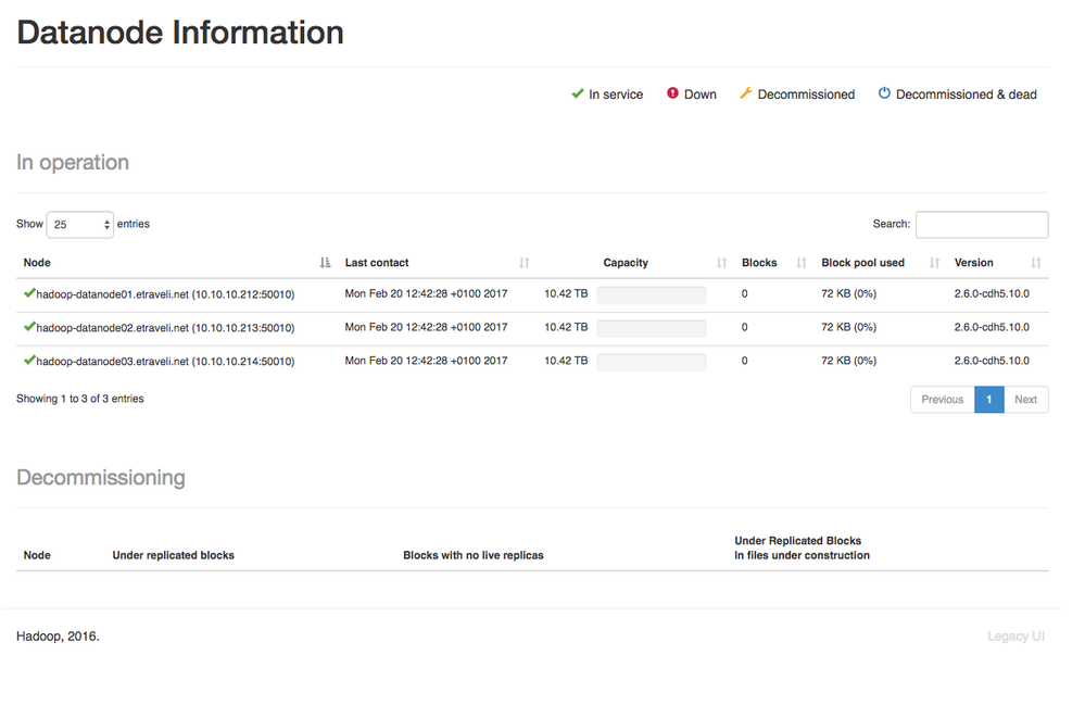

However, datanode ui is empty, don't know if its supposed to show something more:
Screen Shot 2017-02-20 at 12.42.16.pngScreen Shot 2017-02-20 at 12.42.31.png

So the Datanode pages are usually pretty blank on information but the NameNode one are not. The screenshot you provided seems to show that the DataNodes are reporting into the NameNode.
