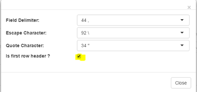

Another way is, Use Ambari and click on HiveView as show in the below screenshot.
then click on UploadTable and if your csv file is in local then click on choose file
if you want to get column names from headers then click on the gear symbol after Filetype dropdown
The table will gets all the column names from csv file headers.
Select the database where do you want to create the table and change the table name if you want to change.
Then click on UploadTable button located at left on the screen.
