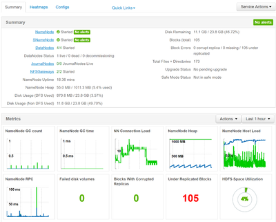

I have a cluster with 4 machines. In each machine has been installed a DataNode. I reported below the screenshots showing the Ambari status.
It is correctly showing 4/4 datanodes however only 1 seems live.
My questions are: *) why is not showing 4 lives datanodes? *) is this affecting also that block are not replicated (see "under replicated blocks") *) also, when running a spark job i get:
YarnSchedulerBackend$YarnSchedulerEndpoint: Container marked as failed: container_e07_1480428595380_0003_02_000003 on host: slave01.hortonworks.com. Exit status: -1000. Diagnostics: org.apache.hadoop.hdfs.BlockMissingException: Could not obtain block: BP-1459687468-127.0.1.1-1479480481481:blk_1073741831_1007 file=/hdp/apps/2.5.0.0-1245/spark/spark-hdp-assembly.jar
Could you please help me on the above issues?

Please check NN UI, if all DNs are active over there. If there are servers marked dead, we will need to see the DN logs on each of these nodes.
Hi All,
i solved the issue adding the following configuration in the "Custom hdfs-site" section.
<property>
  <name>dfs.namenode.rpc-bind-host</name>
  <value>0.0.0.0</value>
</property>
I modified also the following in the "Advanced hdfs-site" section:
from nameMyServer:8020
to ipMyServer:8020
Regards
Alessandro
