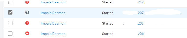

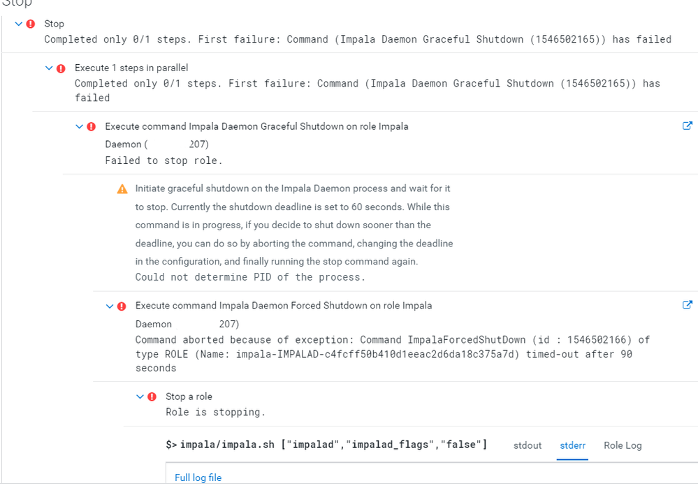

Below is the type of error I get while trying to stop (e.g) impala daemon from the Cloudera Manager console.
On the UI, it shows the status of the service is unknown as shown below. As you can see, the host 207 has a question mark in its status column, which signifies unknown status.

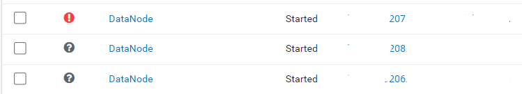

Also, for other host (206, 208), the hdfs datanode has the same issue as that of the impala daemon.
