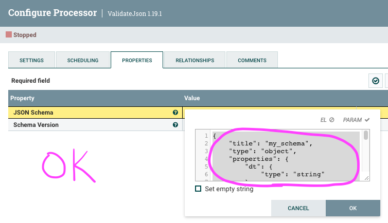

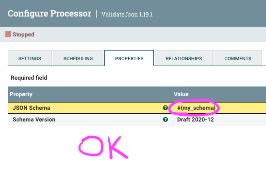

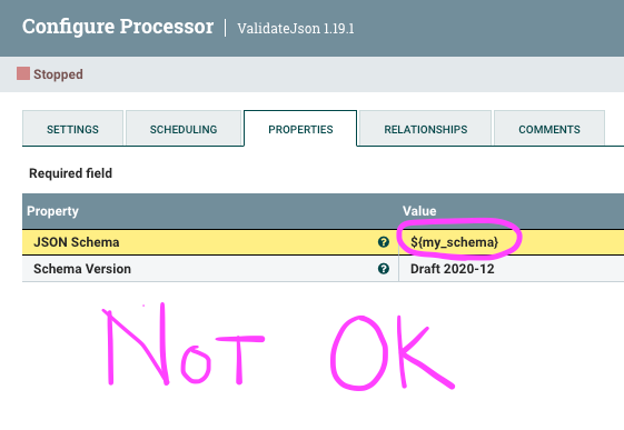

However, we would like to switch to using JSON Schema, but the ValidateJSON processor doesn't support attribute references so the "JSON Schema" parameter needs to either the whole JSON Schema itself, or a hard-coded Parameter Context parameter reference.
What this means is that we need to use a separate ValidateJson processor for each JSON Schema (i.e. 20 schemas = 20 processors).  Ugh!
This is a very significant shortcoming of the ValidateJson processor and makes it unusable except for simple flows with homogenous data.  Hopefully there are plans to expand out its features.
I attached a couple of screenshots to help illustrate the problem.
Screenshot 2023-05-31 at 19.37.38.pngScreenshot 2023-05-31 at 19.36.01.pngScreenshot 2023-05-31 at 19.39.34.png

It does not appear the processor supports dynamic Json Schema values a runtime. It requires exactly one resource.
I don't know if this was because of the "Schema Version" property aspect, where supporting dynamic Json could cause issues since each Json Schema may use different schema versions.
