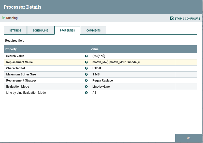

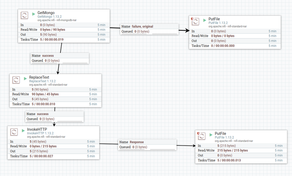

I am trying to get an key from GetMongo Processor and then I am trying to replace the value  in the format
key=value
using  ReplaceText where value here is the result which I am getting and then passing  to different POST API which supports `application/x-www-form-urlencoded`
From GetMongo Processor I am getting value {match_id: 789456}
and In replaceText Processor I am using in Search Value : (?s)(^.*$) and Replacement Value in match_id=${match_id:urlEncode()}
But in API data is getting passed as { match_id: '' } though it should pass as  { match_id: 789456 }
What I am doing wrong in ReplaceText Processor

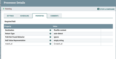

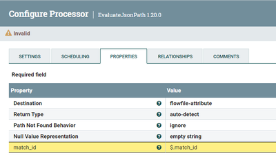

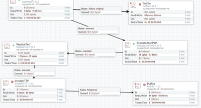

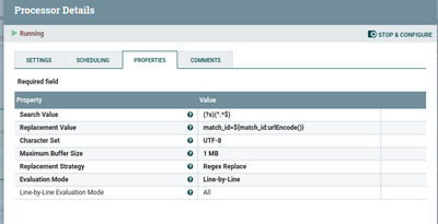

hello @SAMSAL ,
Thanks for your reply. I have tried what you suggested. And even i tried that before but I am still getting same issue. Please find screenshots
Screenshot from 2023-10-02 01-17-09.pngScreenshot from 2023-10-02 01-16-51.pngScreenshot from 2023-10-02 01-17-21.png
I am still getting { match_id: '' }
Super Guru
@piyush7829,
Change the setting of the EvaluateJsonPath "Destination" Property to flowfile-attribute instead of flowfile-content. Setting this property with the later value will change the whole flowfile content and wont create the attribute you are looking for in the replacetext processor. if that still doesnt work, make sure to check after the EvaluateJsonPath to see if the "match_id" attribute was created and populated with the correct value, if not then I need to see the response from the GetMongo processor to make sure the correct path is being set in the EvaluateJsonPath.
