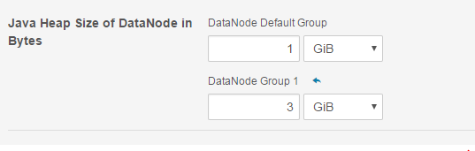

Java Heap for Datanode was 1GB for all 3 DNs. Hence I changed the Heap for only NN's Datanode to 3GB. Also, changed the OOM heap dump back to /tmp Just to see if HPROF files are getting generated or not.
Java heap DN.PNGThanks,

After increasing the Heap size of Datanode role on my NN, I have not seen Hprof files getting created. The issue is resolved.
