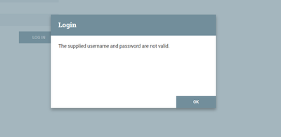

Hi,
I am trying to secure NiFi authentication using LDAP configuration. ). I am able to get to the login screen, but then I am getting an error on logging in ( The supplied username and password are invalid) even though the username and password are correct.Can someone help me in the direction, on what might be the problem?
