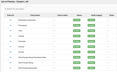

Hi @Scharan
thanks for your response, we already have the policy in ranger by default :
and i already assign our user and group to this policy , but still failed authorization

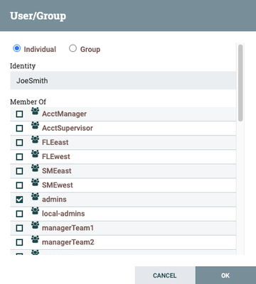

So with your current setup, you would login as your authorized user, go to the NiFi Global Menu, and then select "users". This will open the NiFi Users UI where you should see your initial admin user which you defined in your file-user-group-provider. You would need to click on the
icon to add additional users and groups manually. Adding users and groups here has nothing to do with authentication. You are using this Ui to establish user to group associations. So I would start by creating a new group. The Identity string used must match case sensitive the exact group string as seen in Ranger.
Then you can start adding your user strings (must match user strings case sensitive as seen in Ranger)
As you add users you will be able to select the group(s) you added as those that user should be associated with.
Using above as an example, NiFi would then associate user string "JoeSmith" with group string "admins".
