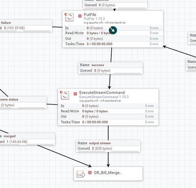

Below is flow which i'm using

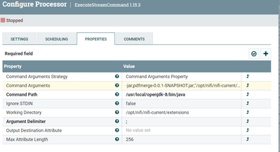

and here is my configuration of executeStreamCommand:
Could you please help me on this?

Finally was able to accomplish this task. after changing the Flow to below.
Before keeping the Flowfiles in putFile path updating filename of each flowfile to same name taking two flow files in respected putfile paths (invoice, QRBill) folders separately and placing them in respective folders using 2 put files. then after putfile  adding merge content(actual merging two files not happening here, but we are getting one single output) to get single flowfile and then in the execute. and then in the execute stream command for both inputs giving that same filename for respective folders.
