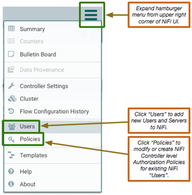

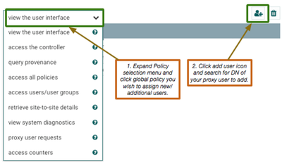

You need to add this as a new user in NiFi:
cn=o.1548691,ou=Users,ou=Accounts,ou=ITSC,dc=zone1,dc=testdev,dc=net
Click "Users" to open the users and groups NiFi UI. The "individual" "identity" string must match EXACTLY with what you saw in the nifi-user.log. It is case sensitive and make sure you have not copied in the single quotes or any leading or trailing spaces.
Click on "Policies" to access the below UI and grant this newly added user a minimum of "view the user interface":
Thanks,
Matt
